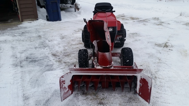

tractorhogg 667 #8 Posted February 24, 2016 (edited) I like the tread pattern on the Super 500s, plus they are, they and the Carlisle Turf-Trac, are the best tires on the market. Or you could go Big Dog and buy some Duro Frontiers or Maxxis Ceros like these rears that will work for about anything, coupled with a 5.70-8 front tire that is 18 inches tall and you have ease of steering and turning, This set up gives great ground clearance for plowing snow and gardening as well. i used four bolt hubs and wheels, but you don't have to. Edited February 24, 2016 by tractorhogg 3 Share this post Link to post Share on other sites

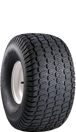

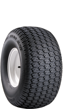

cmcmjk 15 #20 Posted February 25, 2016 Carlisle turf master: Carlisle turf trac rs: I agree the chevron tread is too sharp. The other problem is I do have to mow by the water down a hill! 1 Share this post Link to post Share on other sites
