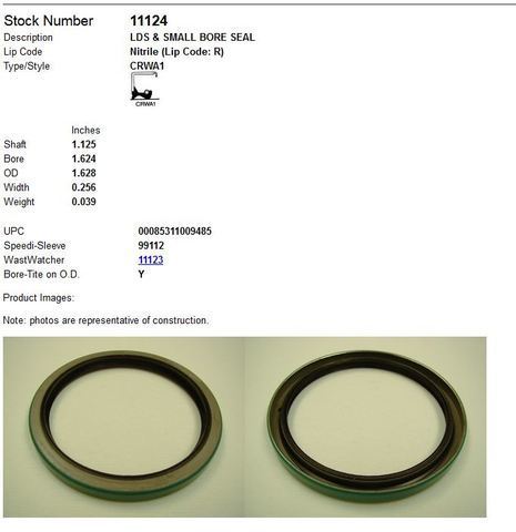

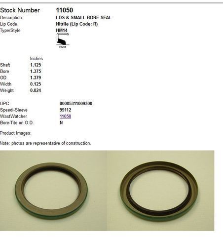

pfrederi 19,940 #18 Posted February 25, 2016 The Sundstrand Hydros used WH # 6449 for axle seals. 8 speeds used 100443. They cross to SKF (CR) 11124 for the hydro which as you can see is really a double lipped seal and SKF (CR) 11050 for the 8 speeds a single lip seal. Maybe WH was thinking keeping dirt out of the hydro systems was more important than for the 8 speeds???? 3 Share this post Link to post Share on other sites

Don Webber 0 #20 Posted March 17, 2016 I read about axil seals. The NAPA seal number was 11124. Do you think that is the right seal for my 1973 Raider? 8 speed-12hp k301. Share this post Link to post Share on other sites
gwest_ca-(File Mod) 12,012 #21 Posted March 17, 2016 1 hour ago, Don Webber said: I read about axil seals. The NAPA seal number was 11124. Do you think that is the right seal for my 1973 Raider? 8 speed-12hp k301. Welcome to the forum. This may be the parts list for your tractor The seal listed is Wheel Horse # 100443 which is Napa CR 11050 or National 340835. The dimensions are up a post or two. The OD of the seal is 1.375" or 1-3/8" for the 1-1/8" axle. Garry 2 Share this post Link to post Share on other sites
stevasaurus 23,619 #22 Posted March 17, 2016 No...the 11124 is not correct for the manual transmissions....you want (if your axle is 1 1/8" dia) SKF 11050. Garry. we posted at the same time. The SKF 11124 is for the Hydros. 1 Share this post Link to post Share on other sites
Don Webber 0 #23 Posted March 18, 2016 Thank you guys. I am new to this sight and you have been a great help. Yes, I do think the SKF 11050 are the right seals for me. Share this post Link to post Share on other sites
