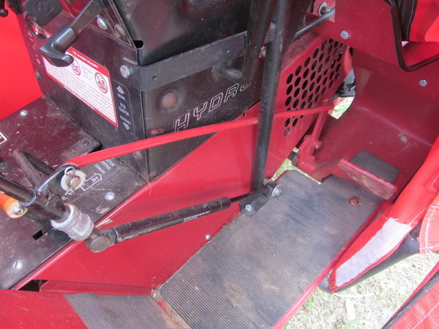

Ed Kennell 47,818 #4 Posted February 23, 2016 I don't have one of Matts foot controls, but I have met Matt at the WHCC show and he makes a great product and I have never heard any negative reports. I don't know if he makes a control for a GT 14 . I also don't know if this would work on your tractor, but here is a pic of the F/R control I made for my '89 520H. 3 Share this post Link to post Share on other sites

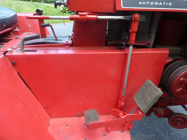

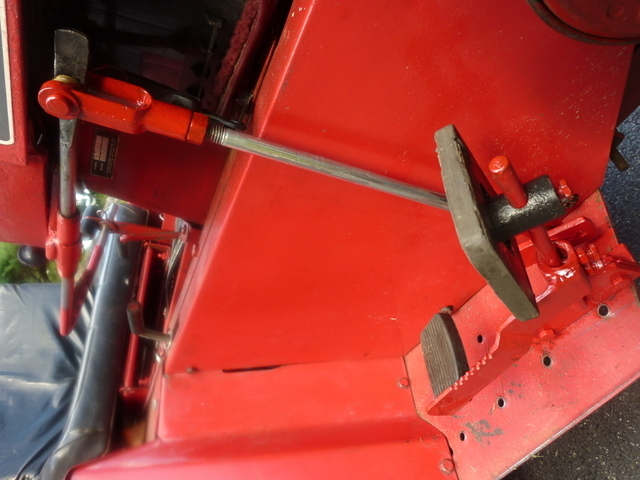

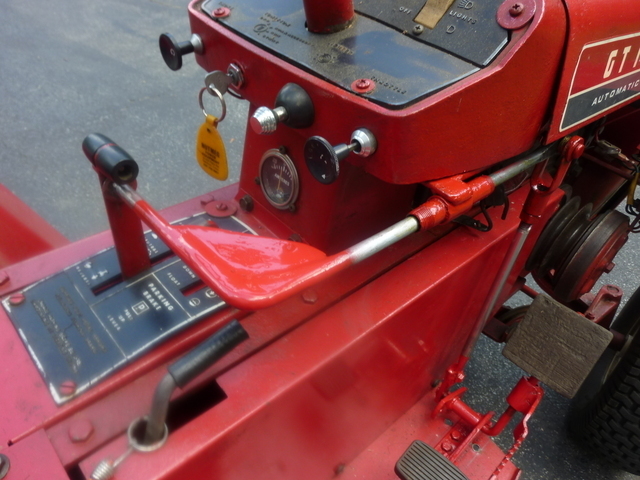

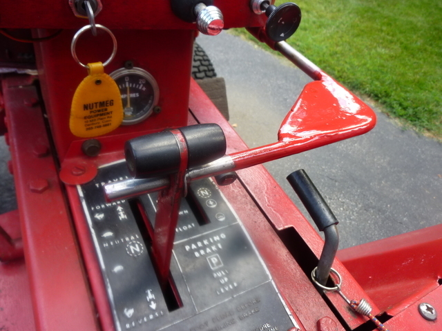

Rob R 993 #5 Posted February 24, 2016 Here's my home made Pedal hydro clutch for the GT14, basically created from parts I had laying around from my tractor stash... works really good and basically unbreakable.... also the "T" handle can be used like always if you prefer like when you backing into a tight spot or shed. 7 Share this post Link to post Share on other sites

Ed Kennell 47,818 #7 Posted February 24, 2016 Hey Rob, I like it. I also like the capability of still being able to use the hand control when I am twisted around in the seat to back in the barn or to hook up a trailer. Just a couple questions. What is the function of the notched piece on the foot pedal? What keeps the horizontal rod from binding in the pipe guide as the vertical rod must move up and down as it rotates ? How much pedal travel do you have from full forward to full reverse ? Does the GT 14 also have the left foot pedal that puts the F/R in neutral and applies the brake ? Share this post Link to post Share on other sites
Rob R 993 #8 Posted February 24, 2016 Okay Ed, will do my best to answer your questions: Hey Rob, I like it. I also like the capability of still being able to use the hand control when I am twisted around in the seat to back in the barn or to hook up a trailer. Just a couple questions. What is the function of the notched piece on the foot pedal? If you notice there are two (2) pedals one for the toe of your shoe (forward) and the other for the heal of your shoe (reverse)... the notched rod is reverse lever operated with you heal this was previously a brake lever from another tractor the ratchet notches were used on it (no longer used) to set the brake. This allows you control the forward and reverse motion very well (overcome friction etc) and control the forward and reverse motion) . I use this mostly when I am snow blowing and with my heavy work boots I found that it was a real pain to try and use the "T" handle while lifting and lowering the blower.. with this foot rocker it is a breeze ... What keeps the horizontal rod from binding in the pipe guide as the vertical rod must move up and down as it rotates ? See my above response there is some binding but the robust parts and simplicity of the design over comes this very well How much pedal travel do you have from full forward to full reverse ? Roughly three (3) inches Does the GT 14 also have the left foot pedal that puts the F/R in neutral and applies the brake ? Yes works same as OEM design by Wheel Horse to put the tractor in neutral no real brake other then that of the Sundstrand auto trans 4 Share this post Link to post Share on other sites
Ed Kennell 47,818 #9 Posted February 24, 2016 Thanks Rob. I couldn't tell from the pic that the notched piece was connected to the heel pad. I used a little different approach from the typical toe/ heel rocker pedal. On my 520H I use a pneumatic cyl to pull the control into reverse. Some feel it is not safe, but it is very easy to use and also a smooth motion when changing direction. Hydraulic lift and foot controlled F/R are the only way to go when blowing or plowing snow where you have to be constantly changing direction and raising the plow and blower. If I keep my 312H for plow duty, I will add a foot control to it also. 1 Share this post Link to post Share on other sites
