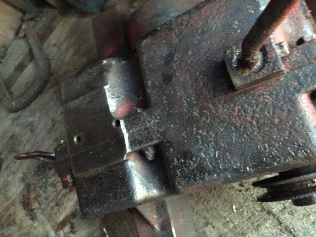

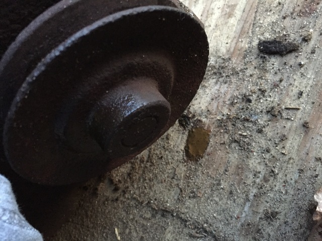

DeHart16 37 #3 Posted February 22, 2016 Man thanks for the reply, lot of great info I will go over tonight... In the meantime I snapped a pic of the last it of oil I didn't clean up, and the two holes it came out of..as you can see I already began wire wheeling the trans... 2 Share this post Link to post Share on other sites
stevasaurus 23,662 #4 Posted February 22, 2016 WOW...thanks for the pictures...they tell a lot. I would say that horse has spent a lot of time outside in the elements. It may not be as easy to open up as I thought. Those hubs, pulley and brake drum may take a little messing around with. In your 1st picture, I see some milky, oil...that is really not too bad, but you do not know if it has been changed a while ago or not. You are going to have to see what comes out...maybe take a look down one of those seat bolt holes... with a light in the other one. 3 Share this post Link to post Share on other sites
