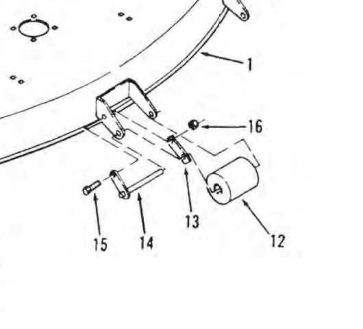

pfrederi 21,222 #1 Posted February 18, 2016 When the grass is tall the front rollers on a deck will spin as they are pushed through it. This causes premature wear of the roller and the shaft it rides on. The rollers are anti-scalp and should only turn when you hit a rough spot. Some older decks included a part 102773, Roller Stop Spring. #13 in picture. It is of course NLA. Has any one come up with a work around...(Yes I should mow before the grass gets to tall but....) 1 Share this post Link to post Share on other sites

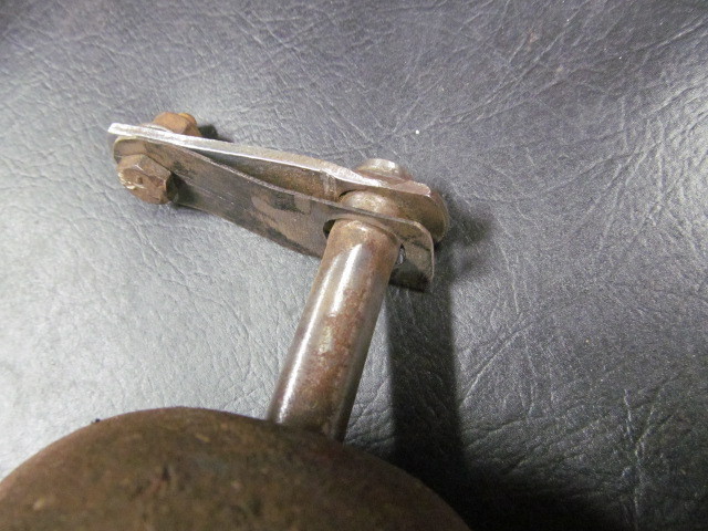

Ed Kennell 47,607 #2 Posted February 18, 2016 I didn't know these existed Paul. I have used spring steel strapping material to make these types of springs. I'll make a few to see if it works. 1 Share this post Link to post Share on other sites

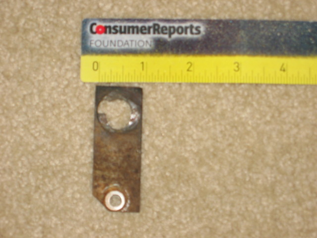

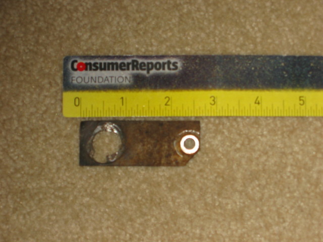

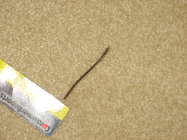

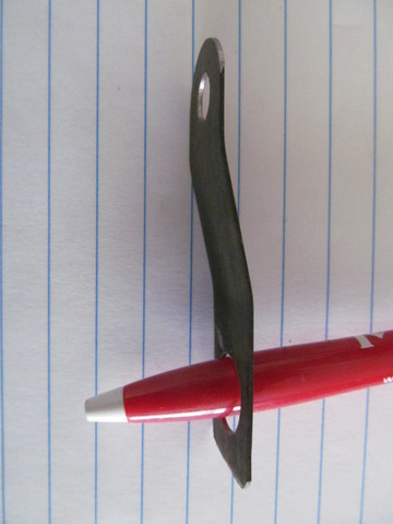

pfrederi 21,222 #8 Posted February 20, 2016 Found an old deck I am not using had one of these stops.. at 1 " wide that is wider than any strapping material I have. 2-5/8" long Not teh hole is really an oblong (to allow it too move back an forth over the shaft as it flexes). Hole (less teh missing chunk) is 1/2" x 5/8". The cut off corner is to clear the bracket on the deck itself. Have to see if I can find some 1" spring steel. 1 Share this post Link to post Share on other sites

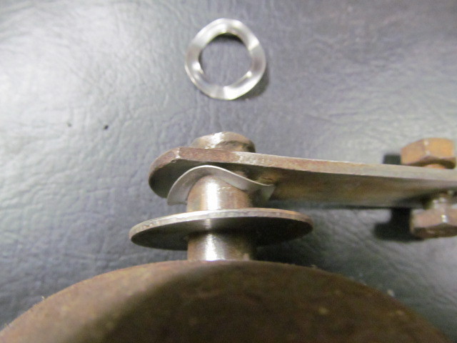

Ed Kennell 47,607 #9 Posted February 20, 2016 Thanks for the dimensions Paul. I didn't have 1" wide either, so I made one out of 3/4" and it worked fine, but probably won't last as long as the 1". But while making this, my thought was ...why not use a simple wavy washer for a spring? Road trip to ACE. 5 Share this post Link to post Share on other sites

Ed Kennell 47,607 #11 Posted February 21, 2016 ACE has the 1/2" wavy washers @ $0.74 each. They seem to work OK, but I had to bend the roller side support in to get the correct tension on the spring washer. The washers don't have the range that the flat strap spring has, but both worked. 1 Share this post Link to post Share on other sites
pfrederi 21,222 #12 Posted February 21, 2016 Great idea and cheap.. i like that. Did you put wave washer on each side of the roller??? 1 Share this post Link to post Share on other sites

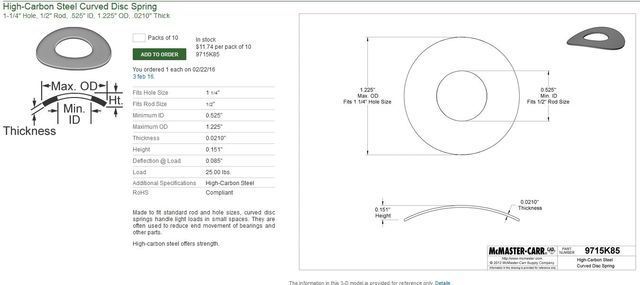

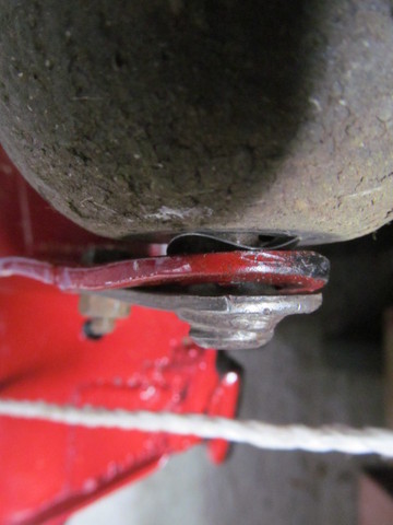

pfrederi 21,222 #13 Posted February 24, 2016 I tried a different washer. Used one per roller and put flat washer on to take up any residual looseness. Rollers will still turn but you have to push hard on them. They put up to 25 lbs resistance. 2 Share this post Link to post Share on other sites
Ed Kennell 47,607 #14 Posted February 24, 2016 On 2/21/2016 at 4:46 PM, pfrederi said: Great idea and cheap.. i like that. Did you put wave washer on each side of the roller??? I only used one wavy spring washer on each roller and it worked fine. The ACE washers have the double bend so both sides have a smooth curved contact surface. This may allow the rollers to turn with less force than the single bend washers. 1 Share this post Link to post Share on other sites

Charbs152 257 #21 Posted December 2, 2020 On 2/24/2016 at 4:19 PM, pfrederi said: I tried a different washer. Used one per roller and put flat washer on to take up any residual looseness. Rollers will still turn but you have to push hard on them. They put up to 25 lbs resistance. I just ordered these. thank you. about how many flat washers did you end up using? Share this post Link to post Share on other sites
