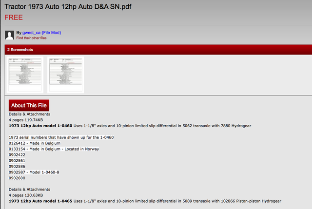

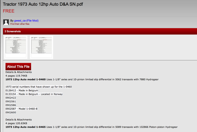

WNYPCRepair 1,924 #2 Posted February 17, 2016 9 minutes ago, 1973Auto said: Need help fast at tractor supply. Need belt size for my 73 12hp auto. Drive belt 82 or 83 inches. Trying to find a model number, hang on I think your model number is 1-0460 and the belt pn is 7478 at 84". Without knowing the model number for sure, I am guessing based on this model 1 Share this post Link to post Share on other sites
stevasaurus 23,662 #3 Posted February 17, 2016 wh #7478 is 84" x 5/8" 1 Share this post Link to post Share on other sites

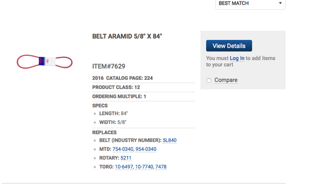

Tankman 3,528 #6 Posted February 17, 2016 TSC has the Huskee Kevlar belts stock. I use 'em all the time, never had this belt fail. http://www.tractorsupply.com/tsc/product/huskee-kevlar-v-belt-5-8-in-x-84-in?cm_vc=-10005 Share this post Link to post Share on other sites
