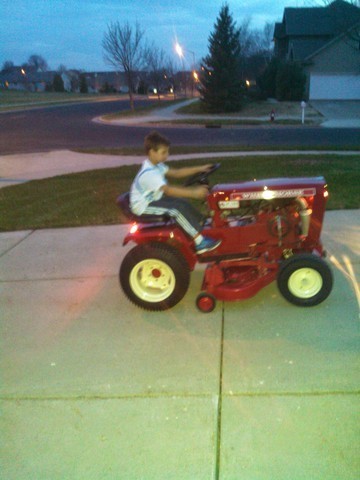

can whlvr 994 #11 Posted February 18, 2016 I have a 101,rebuilt her a few years ago,every bolt including tranny came off this girl,i rebuilt the engine,new piston,rod,rings,bore the whole deal,she is a good runner and very stout for a small engine,but for large snow falls the 42 single stage is a little too much,shes in the govorner too much for my liking,but as far as the rest,grass cutting as long as you arnt bush hogging she will cut fine and plowing its more than enough,i would get both,the 10 horse and the 16 hotse,heres a pic of the 78,c101 in her new outfit,and one of her original 3 Share this post Link to post Share on other sites
