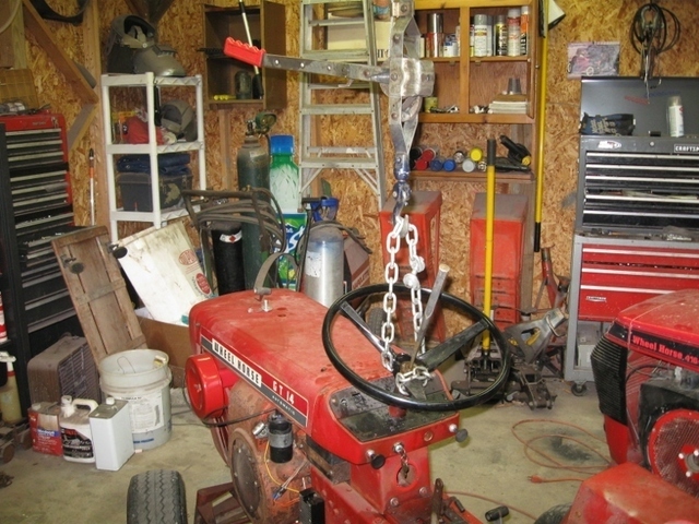

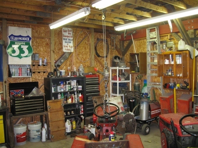

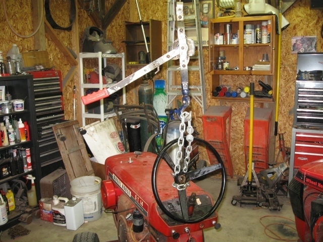

N3PUY 1,031 #5 Posted February 16, 2016 (edited) Here's how I got mine off ..... hoisted the whole tractor by the steering wheel and pounded the shaft out. Edited February 16, 2016 by N3PUY 2 Share this post Link to post Share on other sites

MWR 321 #9 Posted February 16, 2016 13 hours ago, N3PUY said: Here's how I got mine off ..... hoisted the whole tractor by the steering wheel and pounded the shaft out. Looks like something I would do. 1 Share this post Link to post Share on other sites
