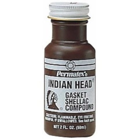

WHX?? 55,183 #11 Posted February 17, 2016 52 minutes ago, MWR said: It didn't leak. I guess thats what counts no matter how you make it! With all the hi-tech sealers out ther these days it's a wonder we have to make them at all. Next time your in a auto parts store guys check ouy how many different kinds of gaskets in a tube there are! Mind bogling as to which one is the right one for what you are sealing. How many of you guys use the the old school gasket shellac? 2 Share this post Link to post Share on other sites
