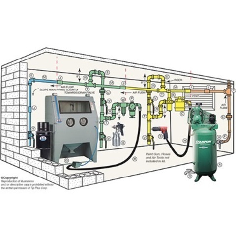

squonk 43,794 #3 Posted February 10, 2016 Look at this diagram from TP Tools. Use metal piping and get that filter away from the compressor. You need the air to cool to so the moisture will condense and the filter will trap it. Lots of good reading about solving moisture problems in their catalog. http://www.tptools.com/ 3 Share this post Link to post Share on other sites

squonk 43,794 #9 Posted February 12, 2016 The trick is cooling the air below dew point so the water traps ( filters) can catch the water. That's one reason not to use plastic lines. Metal lines help cool the air. Share this post Link to post Share on other sites
