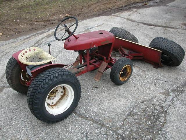

slammer302 2,157 #1 Posted February 10, 2016 I was hoping someone could post sum measurements of the foot rests like the ones in this pic. width length and how far down before the first bend. Thanks for any info! 1 Share this post Link to post Share on other sites

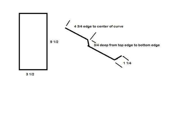

slammer302 2,157 #2 Posted February 10, 2016 I found what i was looking for but will add this drawing just in case i'm not the only one looking for it. 3 Share this post Link to post Share on other sites

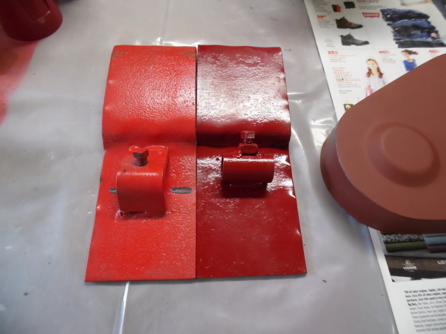

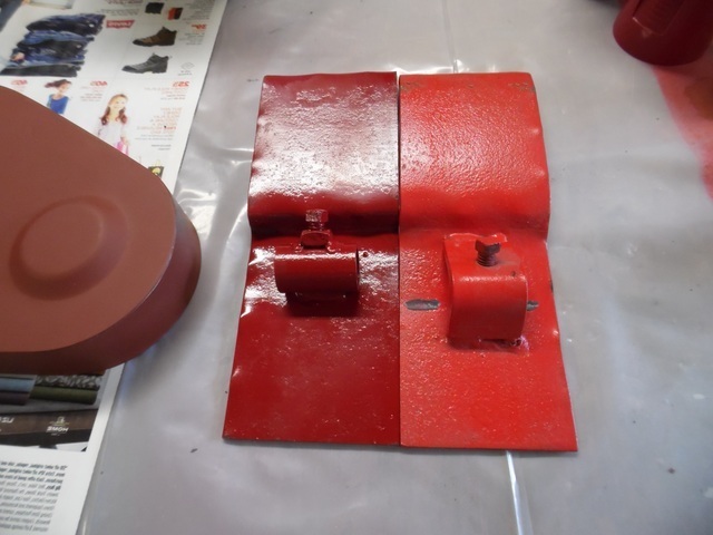

slammer302 2,157 #3 Posted February 11, 2016 Can some one post a pic of the bottom of one of these foot rest so i can see how they attach to the tractor? Thanks 1 Share this post Link to post Share on other sites
Molon_Labe 731 #4 Posted February 12, 2016 I came across two different types of attachments when looking for a set Slammer. 3 Share this post Link to post Share on other sites
stevasaurus 23,619 #5 Posted February 12, 2016 The one on the right looks like factory. Share this post Link to post Share on other sites
slammer302 2,157 #6 Posted February 12, 2016 Thanks for the help Share this post Link to post Share on other sites
buckrancher 2,695 #7 Posted February 13, 2016 9 hours ago, stevasaurus said: The one on the right looks like factory. I will look tomorrow but I believe the one on the left is factory Brian Share this post Link to post Share on other sites
new2horses 287 #8 Posted February 13, 2016 All that I have seen look like the one on the left. Share this post Link to post Share on other sites

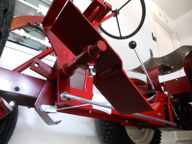

Racinbob 12,794 #9 Posted February 13, 2016 (edited) My 400 foot rests are like the one on the right. Initially I just figured the left one was home made but based on the responses I'm now thinking they probably did them both ways. Just another one of the gazillion things that messes with the minds of WHA victims. Fortunately the 61 foot rests were much better. Edited February 13, 2016 by Racinbob Share this post Link to post Share on other sites
oliver2-44 11,235 #10 Posted February 13, 2016 I have one that looks like the one on the right that "appears' old original factory, Racinbob is probablr right, they did them both ways! Share this post Link to post Share on other sites
Racinbob 12,794 #11 Posted February 13, 2016 21 hours ago, Molon_Labe said: I came across two different types of attachments when looking for a set Slammer. I just saw your cool big show banner picture Major. You've got the type on the left. I'm beginning to think the Ponds would hold special meetings to plot how they could drive folks nuts 50+ years later. 3 Share this post Link to post Share on other sites
stevasaurus 23,619 #12 Posted February 13, 2016 I was just thinking the weld on the left looks like one of mine. 1 Share this post Link to post Share on other sites
953 nut 64,189 #13 Posted February 13, 2016 @stevasaurus, on the left? 2 Share this post Link to post Share on other sites

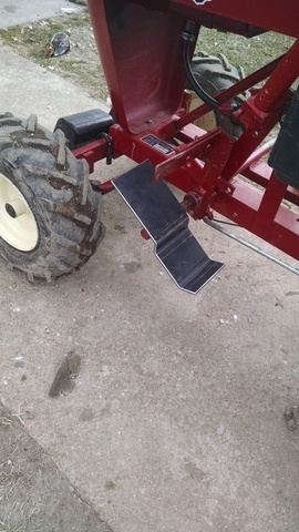

slammer302 2,157 #14 Posted February 13, 2016 I made set their not diamond plate but they will work 4 Share this post Link to post Share on other sites
russellmc301 601 #15 Posted July 4, 2016 (edited) @slammer302 how long of medal is needed total to get the right size ones with curves and everything, i think i have it right but not sure. Thanks Edited July 4, 2016 by russellmc301 Share this post Link to post Share on other sites
953 nut 64,189 #16 Posted July 5, 2016 9.5 X 3.5 each. Share this post Link to post Share on other sites
russellmc301 601 #17 Posted July 5, 2016 thanks alot Share this post Link to post Share on other sites
