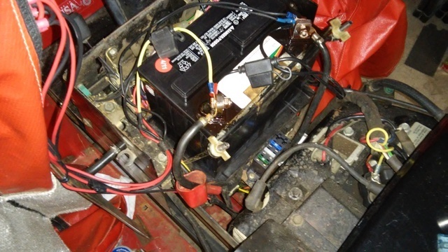

Theroundhousernr 589 #13 Posted February 9, 2016 Some of mine have done this and others don't. What worked for me usually was just a spray of WD40 every so often on the terminals. My 416H blower has got a lot of electrical mods done to it recently and when I opened the hood this year after its summer deep sleep, I saw the evil corrosion. It did also sit on the battery tender all year. The battery is from 2011 so I think it has seen its day but it still fires up and works wonderful. Like others have said, its from the battery gassing out. Cleaning with something like baking soda neutralizes the acid and stops it for a little. The key is to try and protect it once clean. I always liked the shot of wd40 but decided to spent a few bucks on battery terminal protector from NAPA. Seems to have good reviews but it says to re apply once a year. Basically like an orange anti-corrosion paint. We will see I Guess. I think the best thing is to stay after it once you notice it. Share this post Link to post Share on other sites

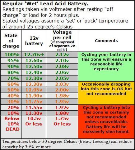

lynnmor 9,081 #14 Posted February 9, 2016 (edited) Often the corrosion happens when a battery is near end of life and is out-gassing. Keep the battery fully charged at ALL times, running it down will shorten the life. I run a Battery Tender (brand name, not cheap imitation), about 3 to 4 days per month on batteries that are not in regular use. Don't just put it on for less than a day, or it won't achieve maximum charge despite the green light being on. Edited February 10, 2016 by lynnmor Added Photo Share this post Link to post Share on other sites
