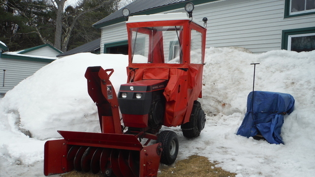

jeff lary 173 #14 Posted February 18, 2016 (edited) . SHANREN LED Work Light Lamp Off Road High Power ATV Jeep 4x4 Tractor 27w 60 Degree… 3 Well the rear facing light was an old fog light I had from my Polaris ranger. I just bought them at Walmart I think. one of the two quit so I had the one left over. But since last fall I did something to it , I hit a limb I think and it quit. So I went to Amazon and bought 3 like I had on the front of the cab I will have 3 in all now on the horse cab 2 in front and 1 in the rear and still have 2 left over. I stopped at motor supply yesterday and bought a 10 amp inline fuse it is the new style not the old glass tube kind. I have yet to get the fuse and the new rear light installed. I have been over hauling a chainsaw just got it back together yesterday afternoon. Your package was delivered. I don't know how to explain which light I bought the other day but here they are 9 bucks each free shipping. Below is a photo of the cab last winter the light on the back is the small fog light which has since quit working. I will replace it with one of these., and have to left over for spares. Something I almost always do is when I need something I buy 2 or 3 extra if the price is less than say 30 dollars for instance. That Blue thing is my generator it is on a dolly I built I get it up and running and move it into position and leave it there for the rest of the winter incase I need it. Go prepared they say and I do try to Edited February 18, 2016 by jeff lary removing personal information from the site accidently put here by me i want to show you the kind of light i bought. So i went to amazon and copied my purchase and pasted it here. But it also came with a link to my account not good ha ha. 1 Share this post Link to post Share on other sites
