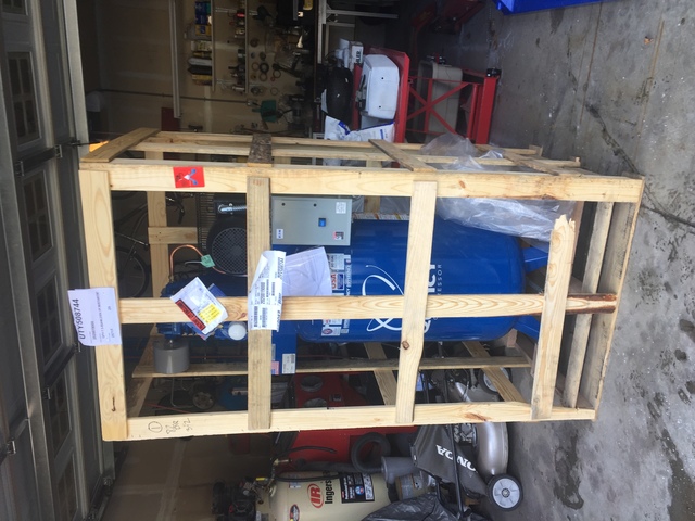

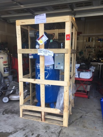

Aldon 4,834 #26 Posted March 2, 2016 (edited) WooHoo Look what arrived today and my door! Probably take a couple weeks before I get it installed as I avoid working in garage in low temperatures. Fir a while I would occasionally turn my phone horizontal to get a picture and that was causing images to be posted rotated 90 degrees. But lately it rotates photos 90 degrees on its own initiative that were taken with phone camera in the vertical. No idea what's driving that.... Edited March 2, 2016 by Aldon 3 Share this post Link to post Share on other sites
ztnoo 2,302 #27 Posted March 2, 2016 Thought I'd better help you get that thing turned right side up so the crankcase oil doesn't seep into the head....... What a monster!!! What are the CFM air delivery specs on that behemoth? 4 Share this post Link to post Share on other sites

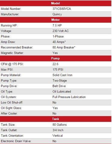

Aldon 4,834 #28 Posted March 2, 2016 Thanks Steve Specs 1 Share this post Link to post Share on other sites

ztnoo 2,302 #30 Posted March 2, 2016 NO!!! Me, pick me!!!! 22.6 CFM @ 175 PSI That's what you call a SERIOUS compressor for a home owner! Plan to establish a compressed air network utility throughout your neighborhood? That would would supply the average demand of several residential garages. 2 Share this post Link to post Share on other sites

ztnoo 2,302 #38 Posted March 4, 2016 Yikes!!! You must be saying that was a 3 phase powered compressor........am I reading you correctly on your description? I don't think Aldon's is 3 phase (his spec sheet says its single phase), but he may encounter demand exceeding the practical limits of not only the circuit on which it is dedicated, but the main service he has at his location could be inadequate. I'm for now going to assume he has a 200 amp panel.................if not, there might be problems with draw. The specs list draw at 40 amps, but recommend an 80 amp breaker. That's a reasonably serious specification for one single tool in a residence. If using that compressor, it is run for extended periods of time in high load/usage situations, problems with other circuits feeding off the beaker box may occur, not to mention the breaker which feeds the compressor. Aldon, I think we need you to weigh in here concerning these demand/capability questions. I'm pretty sure you have considerable knowledge and background in electricity and circuitry, so smooth over the questionable rough edges for us amateurish Reddy Kilowatt types. I jokingly talked about a separate meter and dedicated service, but until we know what you have in the way of residential service, we're howlin' at the moon..... Steve 1 Share this post Link to post Share on other sites
Aldon 4,834 #39 Posted March 4, 2016 I have 200 amp service. House is about 7 years old and wiring is done right with modern materials. Its a 4 bedroom residence, no central AC, propane stove and heat. usually only wife and I. So only other large draw items during spring/summer/fall periods will be the electric dryer and the water pump(well) occasionally. As has been noted I don't do well in cold. Well I don't like to work in high heat either. Most of my sand blasting and therefore high use of compressor will be early in morning until mid afternoon. Usually on Saturdays. The wife usually sleeps in a bit then takes off and does the weeks shopping. I am comfortable that the 200 amp service will handle the load. If if however I find I trip the main breaker with any frequency, then I'll move forward with a separate service. If that becomes the case, I will further regulate when I utilize it against the wife's activities until a new service is installed. I am sufficiently experienced with electrical and electronics that I am comfortable navigating forward and will adjust accordingly. Share this post Link to post Share on other sites

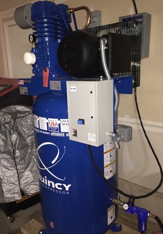

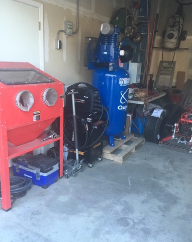

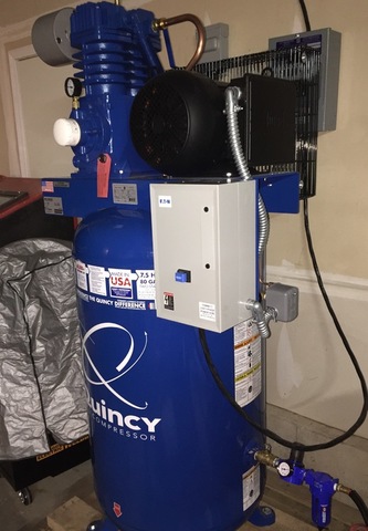

Aldon 4,834 #50 Posted March 14, 2016 Eureka ! We have power and air! I still need to order the regulator and filters I will eventually use but for the moment the CH stuff will suffice to test the system. The unit is surprisingly quiet in comparison to the single stage non pressure oiled 3hp compressor I was using. After initial fill, I blew dirt and dust out of the garage to assure it cycles correctly. It only took about 45 seconds to refill and shut off again. Granted I stopped blowing dirt and was scrambling to hit the stopwatch so I may be off a few seconds. At this point, I am extremely happy with it. While it is suggested in the specs to use an 80 amp breaker, I ended up with a B-box as I could not source a junction box big enough for what I was trying to do. And since Box stores don't carry 80 amp breakers and I wanted to test this puppy out, I have the 80 amp breaker at the main panel and I used a 60 amp breaker at the B-box. No issues. I may leave it that way as it makes me more comfortable knowing that the 6awg run is protected to 60 amps. I have to work tomorrow but have Tuesday off so hopefully get to do a test while sandblasting:-) 2 Share this post Link to post Share on other sites
