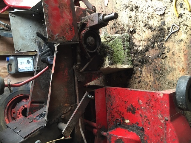

DeHart16 37 #9 Posted February 7, 2016 Yessssir...thanks for posting so I took my hubs off, now what?? Also so as you can see to the far left of my photo the previous owner did some welding...now I have to get this steering wheel of before I can get the entire tool box, gas tank stand off.... Alright pic is on its side? Share this post Link to post Share on other sites

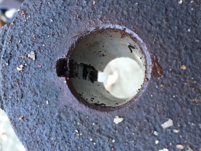

Achto 32,560 #10 Posted February 8, 2016 Now that you have your hubs off I would check to make sure there is no damage to the key way in the hub. If your key way is damaged you could run the risk of damaging the axel or breaking the hub in the future. Same thing could happen if the key is wore. In the picture you can see how the key way is wore on this hub. If yours is wore I would replace it. Good luck with your project! Share this post Link to post Share on other sites
DeHart16 37 #11 Posted February 8, 2016 Each of my key ways are what I would consider slightly worn. Here is a pic of the worse of the two...does this need replacing? What are my options? I really don't want to replace if it does need it. Share this post Link to post Share on other sites
WHX?? 57,941 #12 Posted February 8, 2016 Doesn't look the worse might be ok with a new key if this girl isn't going to get worked hard. Try to position the hub back on the axle in a slightly different spot. Drill & tap for another set screw 90 deg fron the old one is something guys have done too. Share this post Link to post Share on other sites
Achto 32,560 #13 Posted February 8, 2016 I would agree, yours don't look too bad. A second set screw like WHX6 suggested would also be a good idea. Share this post Link to post Share on other sites
