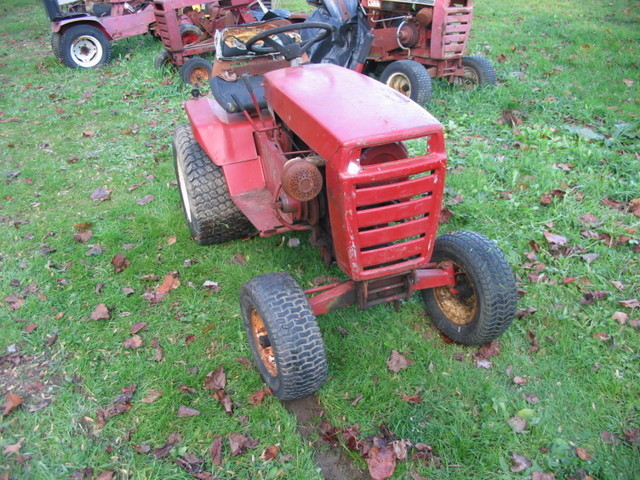

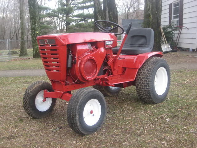

daveoman1966 3,884 #2 Posted February 6, 2016 Since they are the same style tractor they should swap equally. I have a pic of each, but not good enough to give you 100% confirmation. Here is a charger 12 hood....looks the same as the R10. Share this post Link to post Share on other sites

neil 2,416 #4 Posted February 6, 2016 I'm pretty sure they are universal , they all have the same hood stand & the chassis is the same size so would allow the changing of hoods. I prefer the earlier hood . 1 Share this post Link to post Share on other sites

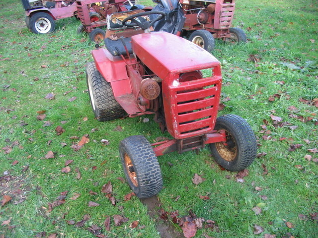

daveoman1966 3,884 #5 Posted February 6, 2016 Is the charger 12 also a 1972? ok, if so. but earlier chargers had a hood as in the pic above. Your R10 hood look shaped like this pic? Share this post Link to post Share on other sites

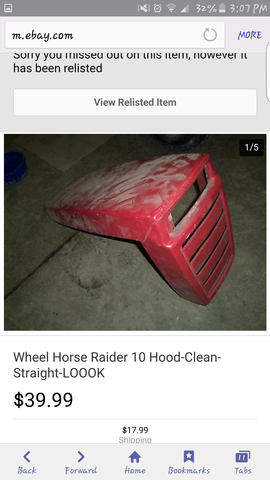

nickj21 20 #7 Posted February 6, 2016 11 hours ago, daveoman1966 said: Is the charger 12 also a 1972? ok, if so. but earlier chargers had a hood as in the pic above. Your R10 hood look shaped like this pic? I actually have a charger 12 and was wondering if a raider hood would fit because i cant find a hood originating from a charger. 11 hours ago, daveoman1966 said: Is the charger 12 also a 1972? ok, if so. but earlier chargers had a hood as in the pic above. Your R10 hood look shaped like this pic? I have a charger 12 and i cannot find a hood from a charger but the raider 10 hoods look the same. But yes that is the hood i need Would this be the right hood? Share this post Link to post Share on other sites

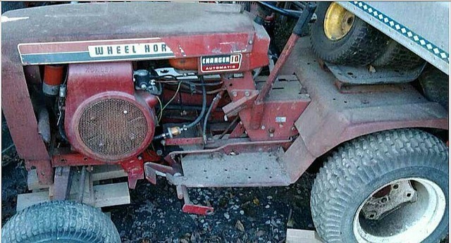

Cole J. 71 #8 Posted February 15, 2016 Here is a charger 10 hood Not the best pic Share this post Link to post Share on other sites
