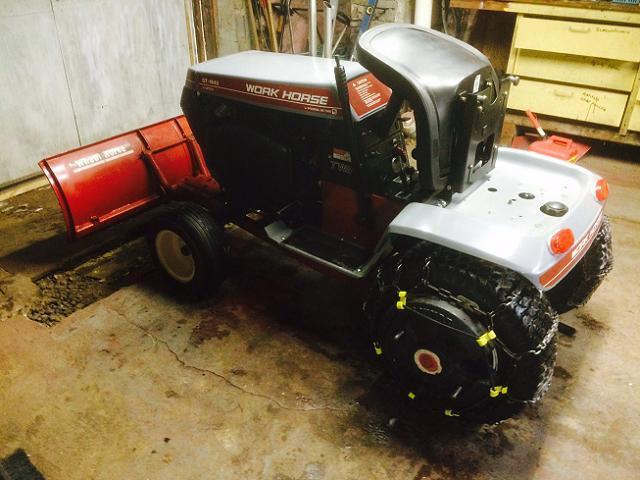

WHX?? 58,347 #4 Posted February 4, 2016 Check this site out http://www.tirechain.com/ They have about every size & type chain imaginable. Good prices & fast shipping. Enter your tire size and they will tell you what chain will fit your tires. Be prepared for some custom fitting once you get them as they tend to run large which is better than too small. I got the 2 link spacing for better ride and did not need tensioners. I deflated the tires and fit them tight then reinflate to 10 psi, not going nowhere. Heres a link to another thread on them http://www.wheelhorseforum.com/topic/61022-need-new-tire-chains/?page=1 3 Share this post Link to post Share on other sites
cheesegrader 436 #5 Posted February 5, 2016 I have a few sets from tirechain.com. The Heavy duty 2-link v-bar chains are beastly! They all ran big, and had to be cut down to fit. WHX6 is giving good advice about installation. Get them on tight with the tires deflated, then reinflate the tires for a nice tight fit. If you dont get them tight, they will twist, and the v-bars will turn into the face of the tire instead of digging into the ice. 1 Share this post Link to post Share on other sites
