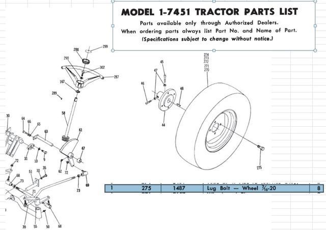

Aldon 4,834 #1 Posted February 3, 2016 All, I want to replace the lug nuts on my GT14. I looked at the manual and despite my misgivings ordered a set based on the information therein. The manual denotes 7/16-20. Well this is incorrect. The actual lug nuts are larger, albeit with fine thread. Bolt sizes are not my forte though. So does anyone know what the correct size is for me to order for the rear lug nuts? I know they are 1 inch long. The pic is of the manual and the incorrect info: Share this post Link to post Share on other sites
gwest_ca-(File Mod) 12,533 #2 Posted February 3, 2016 Mistake somewhere. This is an original 1971 parts list and the GT-14 is the 1GT model The 1487 is a 9/16"-18 in this list The 1004 is 7/16"-20 in this list This is where the 1487 stud shows up https://www.partstree.com/parts/toro/parts/1487/ Mostly D-Series Auto models and the C-195 Auto. The reason the GT-14's don't show up is because Toro pulled the parts lists for them a few years ago. At almost $9 each are they ever proud of them. Have you tried an automotive jobber? Another thought is to use a long threaded bolt from the back and add a regular 9/16" wheel nut on the front side. Garry 1 Share this post Link to post Share on other sites
