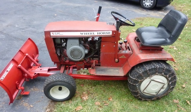

vette10r 13 #1 Posted February 2, 2016 Hey guys I have a 1977 C-81 I got from my Grandpa when he pasts away. I am slowly restoring it and im using it for snow plowing and mowing in the summer. He had some chains for the rear tires but they seem much to big so I ran to Fleet Farm and got some spring to tighten them up. They still do not seem right so im wondering where I can get the correct chains? Im also looking for a new steering wheel as this one is cracked, im looking for all the original stickers so I can re-paint then put the correct stickers on. And I need the chain the hooks the mower deck to the handle that raises and lowers the deck. Can anyone point me in the right direction? Ill make a list below and throw up a picture of her. Im sure I will be looking for more parts in the future that I will add. Thanks Parts Needed: Correct Tire Chains New Steering Wheel Original Stickers Chain That Attaches The Mower Deck To The Handle. 5 Share this post Link to post Share on other sites

Rob R 989 #6 Posted February 2, 2016 Cleat is correct all you need do with the chains is tighten them, you made need to remove one of the cross cleats if you can't tighten enough, chains come in two and four links (one cross link for every two links or one cross link for every four links). Same with the broke eyebolt just replace what's broke the old parts and chains are much stronger then the new one's so use what you have.... Here's my C81 ready to hit the white stuff made mine two (2) link. That little bugger pushes like a bull dozer..... weights don't hurt either. 3 Share this post Link to post Share on other sites
vette10r 13 #7 Posted February 2, 2016 So you must have 2 link and I have 4 link? Where did you get the 2 link, they look like they would hook up much better. Also where did you get the bungy or springs on the outside holding them tight? Share this post Link to post Share on other sites
Rob R 989 #8 Posted February 2, 2016 Yes sir, I bought a set of used chains and made a set of 2 links for the C81 using the extra cross links etc. The springs you see were also from a used set I bought but you could make them easily from old screen door springs.... 1 Share this post Link to post Share on other sites

Wishin4a416 2,594 #10 Posted February 2, 2016 Very nice looking machine. it doesnt look like it needs much of a restore. Looks well cared for. Good Luck!!! 1 Share this post Link to post Share on other sites

vette10r 13 #13 Posted February 3, 2016 2 hours ago, TDF5G said: I don't think it's a 1977. The 8HP tractors were B-80s in '77. It's most likely a '78 or '79. Thanks, my Dad told me it was a 77 im not 100% sure it there a way I can figure out the year? 51 minutes ago, Tankman said: Most auto parts outlets have bungee chain tensioners. If down pressure is required use the "long link." I have a long link but never used it. The chain is required for your mower deck. I only use the short link pushin' snow. I ended up grabbing a piece of steal from fleet farm and made a bar to use with the plow. So far it is working great and I have plenty of down force if needed. But yes I will need the chain for the mower deck this summer so I will be ordering that. 20 hours ago, Wishin4a416 said: Very nice looking machine. it doesnt look like it needs much of a restore. Looks well cared for. Good Luck!!! Thanks! Yes it was well taken care of and runs perfect! I just want to do a fresh coat of paint on everything and replace any broken parts. She ran great in the storm we got here in Minnesota last night too! Thanks for the help with the chains, I tightened them up and aired all the tires to 10 psi and it never slipped once! 2 Share this post Link to post Share on other sites
