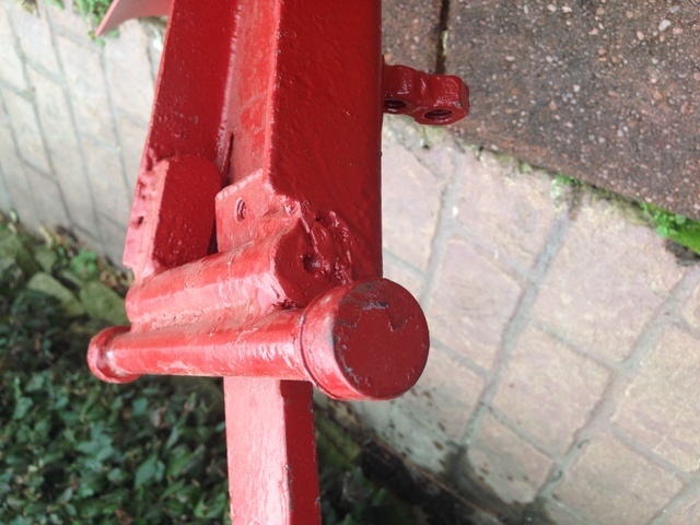

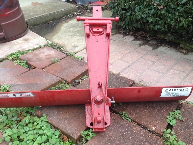

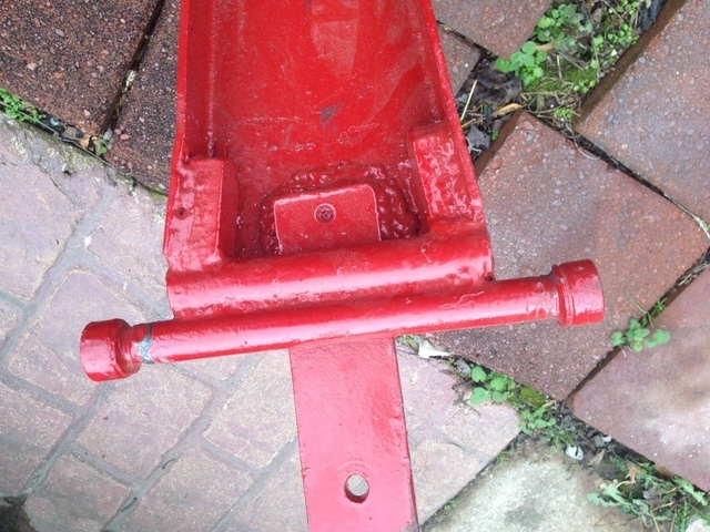

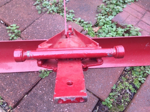

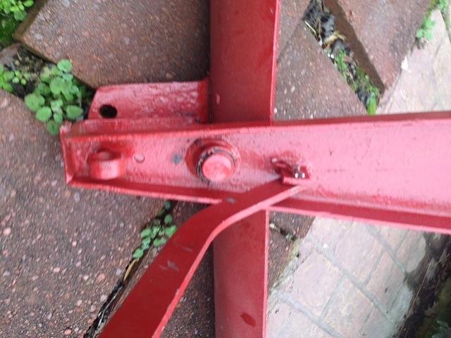

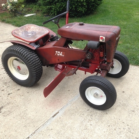

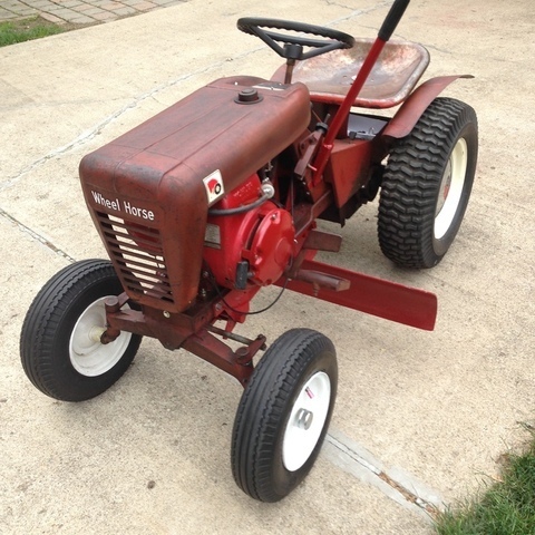

Lane Ranger 12,107 #1 Posted February 1, 2016 I bought this MB-405 Mid-Grader Blade two years ago and I was real please with the modifications the previous owner made to allow the plow to be used in the rear slot hitch as a pull behind plow in addition to being used as designed in the middle of the tractor as a grader blade that could be angles left to right. First two photos are with MB-405 Grader Blade on my 704 Wheel Horse (which I sold late last year) I am posting for those that might want to modify or create a new one like this for their tractors. The last few pictures show the modifications that include an added tongue for placing in the rear Wheel Horse slot hitch and moving the 3/4 inch attach-a-matic connection up about an inch for better clearance under the front steering mechanisms. 13 1 Share this post Link to post Share on other sites
