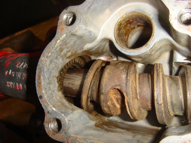

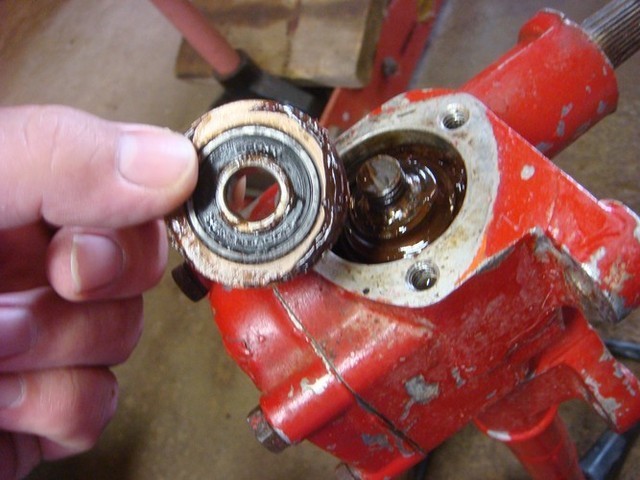

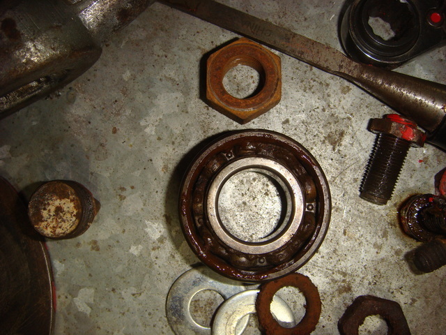

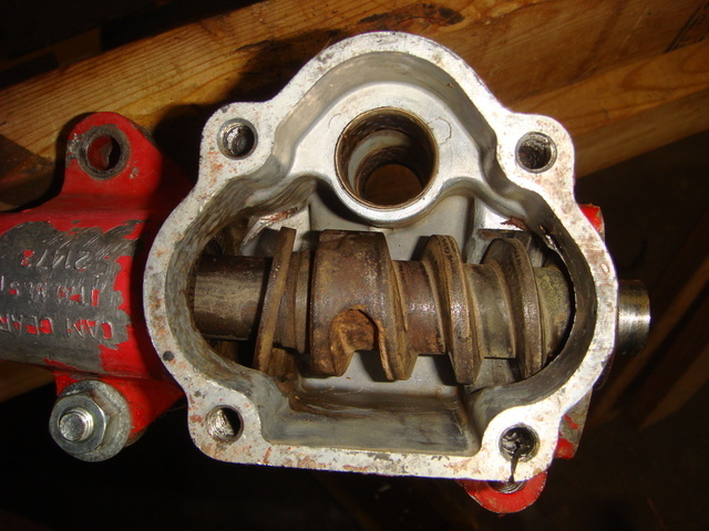

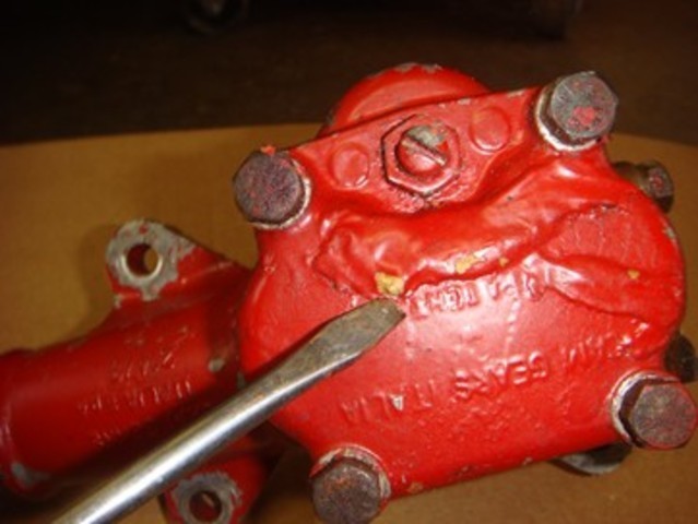

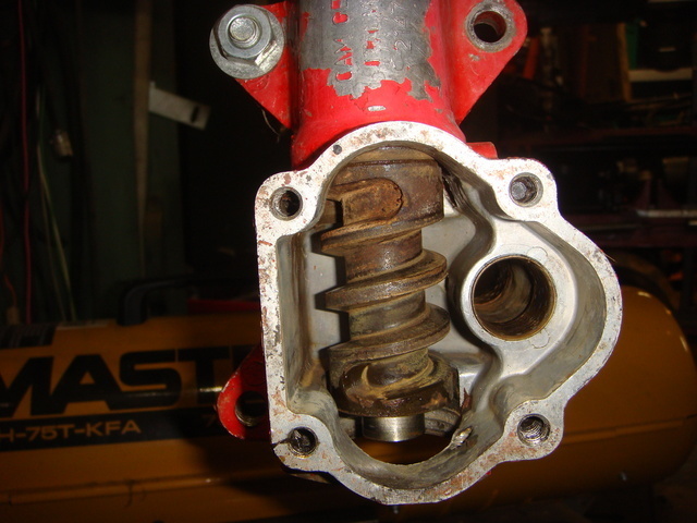

scso81 1 #1 Posted February 1, 2016 Hello all, I just acquired two D-250's, one is the early style, one the later style. However both have bad steering. I was thinking of taking the two and making one good box, but I will still need bearings and gaskets. The second I would like to change it over to hydraulic steering. Has anyone done a hydraulic conversion to one of these tractors? steering and maybe even a pump? Does anyone know a good source for parts? I am new here and would appreciate any assistance. The one gear box I have has been cracked due to I believe being full of water, the second had bearings ground up in it like coffee. 1 Share this post Link to post Share on other sites

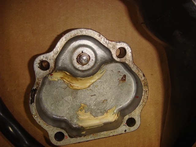

scso81 1 #9 Posted March 15, 2016 (edited) used gearbox received 03/15/2016 Camera DSC-T100 Focal Length 5.8mm Aperture f/3.5 Exposure 1/20s ISO 400 Edited March 15, 2016 by scso81 Share this post Link to post Share on other sites

scso81 1 #11 Posted April 27, 2016 Hi mj The steering issue was a pain. Most that I have run across are either damaged in some way or just out and out scrap. Fortunately I have a cousin who is a machinist. We got our heads together and with a little of his skill and our brains we were able to rebuild my boxes using aftermarket thrust bearings. Now all I have to do is mount one of them and give it a try. But so far looks like it will work great and possibly out last the original! Maybe I should do an update with pics. Hmmmmm Share this post Link to post Share on other sites
