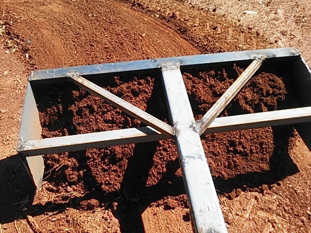

JPWH 6,544 #5 Posted February 1, 2016 (edited) The scarfier blades help break up the soil you are trying to move. The box blade is a good way to drag dirt from one place to another. Here is a simple one I built. I also have homemade. hydraulics Edited February 1, 2016 by Hank01 5 Share this post Link to post Share on other sites

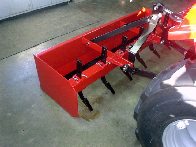

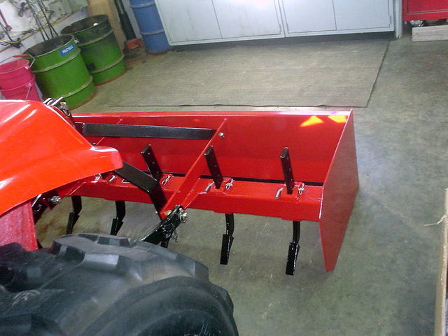

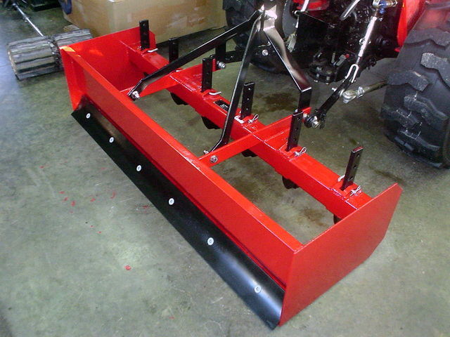

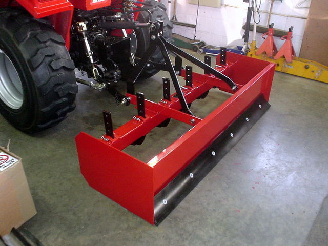

cleat 9,230 #6 Posted February 1, 2016 (edited) The box blade especially if the scarifiers are down deep is the hardest thing my tractor pulls at times. I usually require 4x4 engaged. It does a great job of loosening and levelling but because of the sides holding material in it can get very heavy. For a garden tractor I would think the mid or front blade would be as good or better, just my 0.02. Here are pics of the 72" unit for my CUT. Hydraulic top link is great for the box blade, it lets you keep adjusting the depth of cut on the fly. Cleat Edited February 1, 2016 by cleat 2 Share this post Link to post Share on other sites
