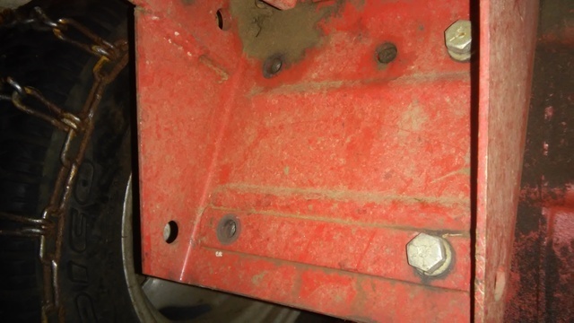

Theroundhousernr 590 #1 Posted January 31, 2016 (edited) So I noticed some jerky movements from my hydro this past storm. I chalked it up to the bushings in the dash column or lack of lubrication. I sat on the my 416H this morning to move it and thought the whole tractor was rocking on the rear wheels it seemed. I lay down on my creeper and find this! Can anyone tell me what size and length bolts this requires, hopefully I can pick some up on my way home and loctite them in. Thanks! Edited January 31, 2016 by Theroundhousernr 3 Share this post Link to post Share on other sites
squonk 48,042 #2 Posted January 31, 2016 EEEKKKK! I think 3/8" by 3/4" They aren't realy long. 4 Share this post Link to post Share on other sites
Theroundhousernr 590 #3 Posted January 31, 2016 (edited) EEEKKK is right!! My thoughts exactly. That would have been a story if the transaxle let loose in 3 foot of snow! The other two are loose to boot! Just was researching, looks like your dead on with 3/8/16 x3/4" Thanks! Edited January 31, 2016 by Theroundhousernr 4 Share this post Link to post Share on other sites

cleat 9,324 #16 Posted January 31, 2016 According to the parts manual 3/8 x 7/8 with lockwashers. Loctite may be a good idea, I would just use blue in case you ever need to remove these again. In order for loctite to work the bolt and female threads in the axle need to be clean and free of grease. Cleat 4 Share this post Link to post Share on other sites
squonk 48,042 #17 Posted January 31, 2016 14 minutes ago, cleat said: According to the parts manual 3/8 x 7/8 with lockwashers. Loctite may be a good idea, I would just use blue in case you ever need to remove these again. In order for loctite to work the bolt and female threads in the axle need to be clean and free of grease. Cleat Has anyone seen a 7/8 long bolt? I haven't and I don't have a story for it. Steve may find a bolt in the bottom of his electryolisis tank 4 Share this post Link to post Share on other sites
stevasaurus 23,834 #18 Posted January 31, 2016 You do need the lock washer. If you are not sure...put an awl or a 3/8" bolt in and measure what you have...give a little room for tightening. Squonk...you are correct. It is not rocket science...if the bolt is too long...put in a shorter one. And Mike is right again, Wheel Horse used some different length bolts...when you can not find them, you can cut them to length. 3 Share this post Link to post Share on other sites

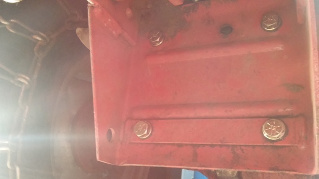

Theroundhousernr 590 #24 Posted January 31, 2016 OK so NEW grade 8 bolts and lock washers. All 4 bolts replaced. I dont mess around when it comes to that stuff. Blue thread locker and beleive it or not , I even torqued them to spec of 35 ft lbs. I just got home and read all these comments and had a good chuckle! Good to go now 9 Share this post Link to post Share on other sites
