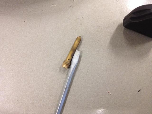

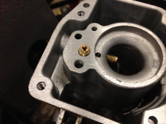

Martin 2,134 #14 Posted January 31, 2016 (edited) did you pull this needle and check to see if its clear? more on this here...... http://www.wheelhorseforum.com/topic/43225-416-adventures/?page=2#comment-396587 Edited January 31, 2016 by Martin Share this post Link to post Share on other sites
Black64galaxie 65 #15 Posted January 31, 2016 Martin. Glad you chimed in. Terry the decal guy. said you are the guru on these. You know what but I don't remember if there was even one on there!! Someone must of been in there before because I don't remember screwing that out of there ! I will have to open up the top again tomorrow. Thanks for the photo. Share this post Link to post Share on other sites

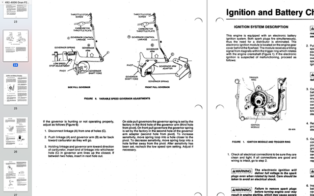

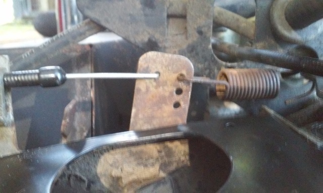

Martin 2,134 #16 Posted January 31, 2016 23 minutes ago, Black64galaxie said: I'll give it a try. They were really sooty so I blasted them in my cabinet nice and clean . But I'll give that a try. Is there a certain number and brand that's correct? I use same plug as was installed from factory, Champion RS17YX. Ive never had problems with hunting or surging from plugs, all of my problems were caused by dirty carb, or poorly working governor assembly, which can range from internal to something as simple as a throttle spring placed in the wrong hole on the bracket, causing incorrect sensitivity with the governor. 1 Share this post Link to post Share on other sites

Black64galaxie 65 #18 Posted January 31, 2016 Yes had the carb cleaner blowing through those good too. I'll hafta look into that top jet. I don't really remember one in there. I don't know how it ran with that out? Share this post Link to post Share on other sites
JackC 619 #19 Posted January 31, 2016 (edited) 1 hour ago, Martin said: which can range from internal to something as simple as a throttle spring placed in the wrong hole on the bracket, causing incorrect sensitivity with the governor. "spring in wrong hole" I have run into that. Are these the correct holes? Edited January 31, 2016 by JackC Share this post Link to post Share on other sites
Black64galaxie 65 #20 Posted January 31, 2016 I'll look into that also. Thanks for picks! Share this post Link to post Share on other sites
Martin 2,134 #21 Posted January 31, 2016 (edited) 10 hours ago, JackC said: "spring in wrong hole" I have run into that. Are these the correct holes? Jack, If you look in the manual, the position in your first pic is one too high. Manual shows the spring in the middle hole. The second pic yours is in the second hole from the pivot, manual states in the text and pic that from the factory the spring is placed in the third hole from the pivot. These are baseline settings. The text also explains the procedure for checking the linkage position (at C) first, then if you feel the need to adjust for sensitivity then to adjust the governor spring position on the governor arm. We have side pull governors so the left pic is the one we need to look at. Edited January 31, 2016 by Martin 1 Share this post Link to post Share on other sites
Black64galaxie 65 #22 Posted February 1, 2016 23 hours ago, Martin said: did you pull this needle and check to see if its clear? more on this here...... http://www.wheelhorseforum.com/topic/43225-416-adventures/?page=2#comment-396587 That was the culprit! No jet in there!!! Share this post Link to post Share on other sites
