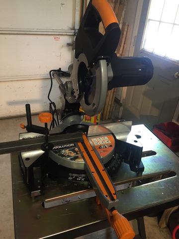

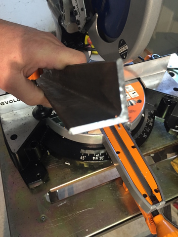

WNYPCRepair 1,924 #1 Posted January 29, 2016 I got a new toy today, so I thought I would share, then I thought maybe others would too, so I picked the title in case anyone else feels like sharing their toys. I know I would love to see some tool porn. Anyway, I found that the plasma cutter works on angle iron and square tubing, but it isn't perfect. Slag at the corners can build up, though that may be my air supply, I still haven't gotten a dryer. Any way, I picked up a band saw, which works, but it isn't easy to keep it straight, and it is heavy. I kept seeing ads for steel blades for mitre saws, and started reading up on it. Turns out, if you slow the mitre saw down you can use these carbide tipped blades to cut steel. No sparks to speak of, no dust, and a nice quick clean cut. So, I decided to try it. Assembled, ready to test In action: The finished cut. In the video, it didn't cut all the way through, though it was only a 32nd or so it easily bent off. I cut again and pressed down hard on the handle at the end, and it just barely cut it all the way, left a hair like piece. It needs a very tiny adjustment. The picture below is from the second cut, after pressing down hard. So far, I am very impressed, although I am convinced one of the carbide teeth is going to fly off and go through my shield and glasses and put out my eye. 2 Share this post Link to post Share on other sites

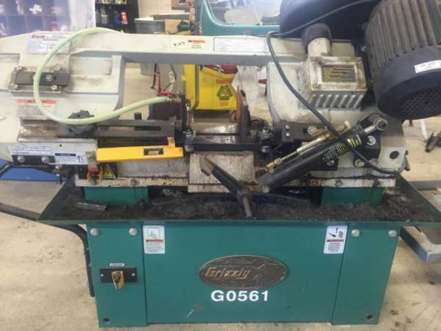

wallfish 20,513 #11 Posted January 31, 2016 (edited) I like the speed of that saw and it's perfect for small materials. One of the best tools I ever bought for metal working is a horizontal band saw. Quick set up time and accurate. Although it's not quite as fast of a cut, you can do other things while it's cutting. Found one of these on CL for less than 1/2 price of new Edited January 31, 2016 by wallfish 2 Share this post Link to post Share on other sites
WNYPCRepair 1,924 #12 Posted January 31, 2016 If I had a shop, I would definitely consider one, I just don't have room. I have to store the mitre saw away between uses now, I need more space Share this post Link to post Share on other sites

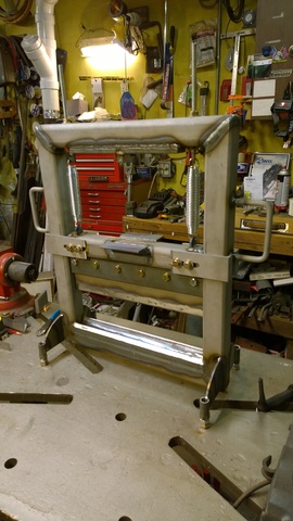

Sarge 3,473 #20 Posted November 23, 2016 i made one of these myself - borrowed the idea from their pictures , use the thing constantly making parts/stuff here in my shop . http://www.swagoffroad.com/SWAG-Portaband-Tables-Accessories_c_35.html Between that , my home built press brake , lathe and the welders , I'm set ...except maybe a mill.. Sarge 4 Share this post Link to post Share on other sites
