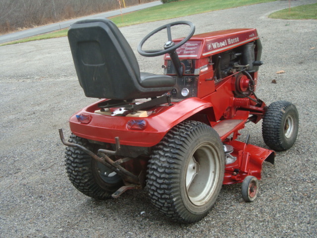

KC9KAS 4,746 #13 Posted January 29, 2016 Check this out... 1 Share this post Link to post Share on other sites
Retired Sparky 526 #14 Posted January 30, 2016 3 hours ago, KC9KAS said: Check this out... Man that's sharp. Where did you pick those lights. Was it costly? Share this post Link to post Share on other sites
DennisThornton 4,773 #15 Posted January 30, 2016 13 hours ago, doc724 said: I bought the oval side marker LED lights (P/N M9-x4) suggested as per the above post. $4.95 ea plus shipping. They are great!. They are a perfect drop in for older bulb style WH lights. Yo do have to drill one hole to get the pigtail out as it does not align with the original WH lights. Some have noted in the past that the lights do not cover completely the holes in the fender...but neither do the original WH lights. Just remember, LED's are polarity sensitive when you hook them up. If you get the polarity wrong they will not work, but they do not get damaged either. I did hear that if your 12V is not regulated well, you may get some flickering, but for $5 it is worth the risk I bought the oval side marker LED lights (P/N M9-x4) suggested as per the above post. $4.95 ea plus shipping. They are great!. They are a perfect drop in for older bulb style WH lights. Yo do have to drill one hole to get the pigtail out as it does not align with the original WH lights. Some have noted in the past that the lights do not cover completely the holes in the fender...but neither do the original WH lights. Just remember, LED's are polarity sensitive when you hook them up. If you get the polarity wrong they will not work, but they do not get damaged either. I did hear that if your 12V is not regulated well, you may get some flickering, but for $5 it is worth the risk I just ordered a couple. Thanks! Share this post Link to post Share on other sites
KC9KAS 4,746 #16 Posted January 30, 2016 10 hours ago, Retired Sparky said: Man that's sharp. Where did you pick those lights. Was it costly? Just regular LED lights. The electronic flasher with 2 modes is what was costly....$25! Share this post Link to post Share on other sites
