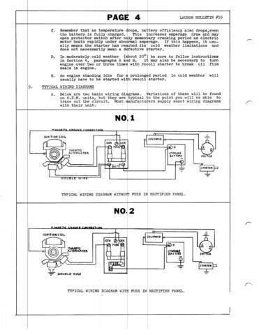

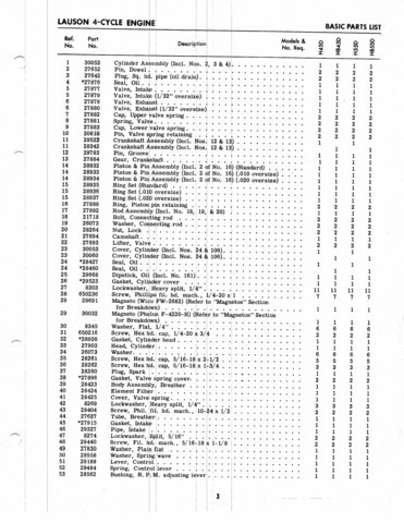

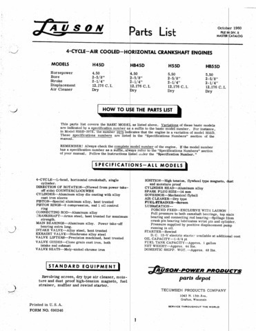

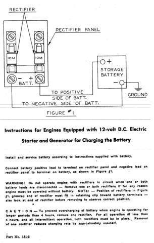

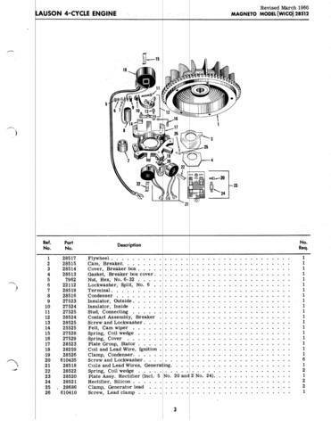

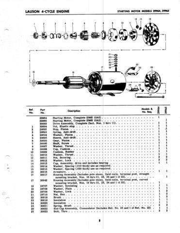

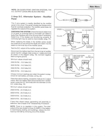

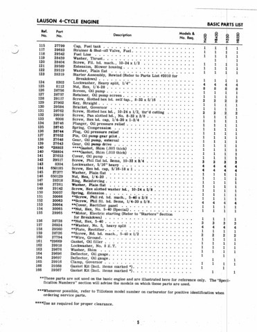

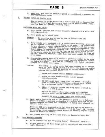

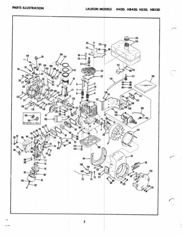

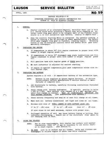

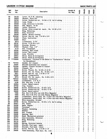

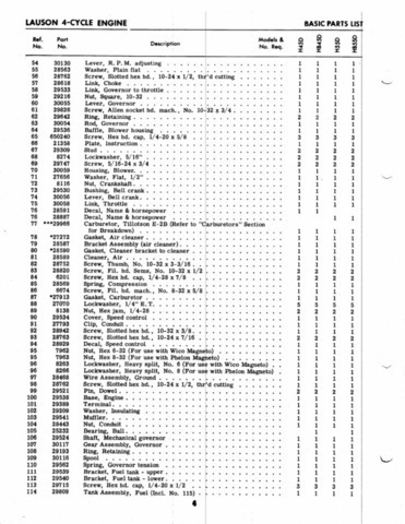

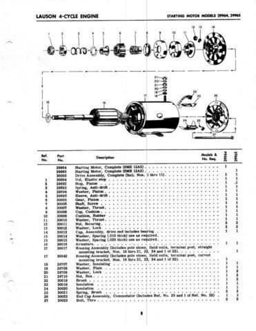

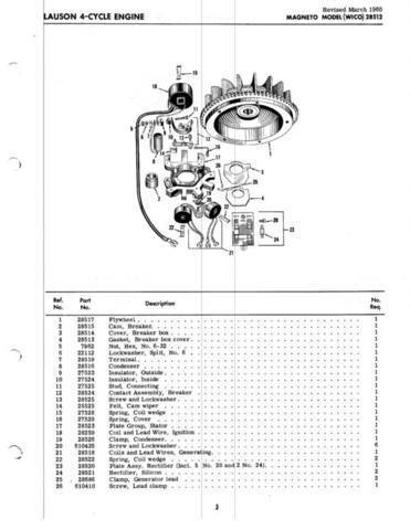

formariz 12,378 #3 Posted January 27, 2016 (edited) Here you go. All H55 engines use the same internal parts regardless of the last 4 numbers. Edited January 27, 2016 by formariz 2 Share this post Link to post Share on other sites
