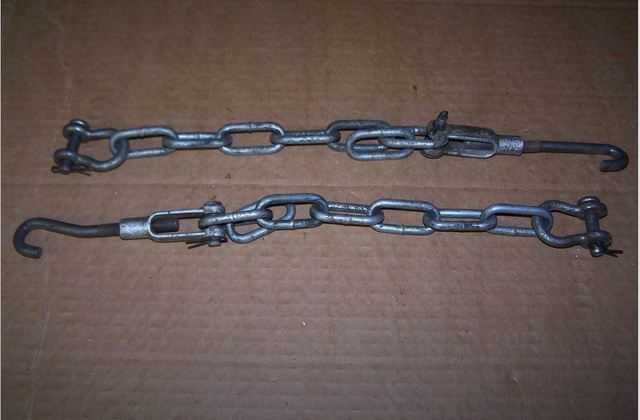

Aldon 4,833 #1 Posted January 25, 2016 (edited) Hey all, just wondering if one of the site vendor/sponsors sells these chain/yoke sets new or if anyone knows a source elsewhere. The yokes are the most necessary part. Chain is easy:) I am all for supporting the site vendor/sponsors if plausible. I would like to replace the set on my GT14 3 point. BTW, I pilfered the pic from "threeHorses" sale thread for easy reference. Would also be interested in a new set of adjustable lift rods. Thanks! Edited January 25, 2016 by Aldon Share this post Link to post Share on other sites

Aldon 4,833 #3 Posted January 26, 2016 Ordinarily yes but smaller than what I have been able to find at tractor supply or other hardware stores. And the the adjustable shafts are unique. Share this post Link to post Share on other sites

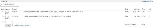

Aldon 4,833 #7 Posted January 26, 2016 (edited) I am posting this in case soemone else in future wishes to replace the 3 point chains. I'm pretty sure the parts I have on hand are 1/4 28 thread. However I had no luck finding an open eye bolt in that thread. I am pretty confident that the thread count on this is not a big deal. I resorted to 1/4-20 thread and found both at McMasterCarr. I was able to get them both zinc plated so they will resist rusting a bit longer. Edited January 26, 2016 by Aldon 1 Share this post Link to post Share on other sites

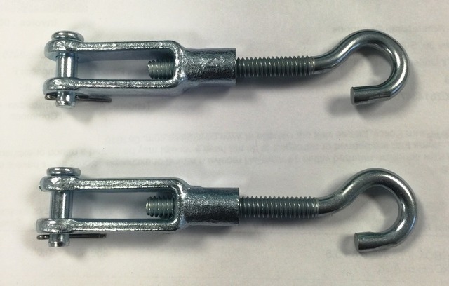

Aldon 4,833 #9 Posted January 27, 2016 I received my new Yoke hardware this morning. This will replace my old rusted up parts nicely. Will not be able to note difference from the original set up. Which may not have even been original. May have been what one of th eprior owners installed. 1 Share this post Link to post Share on other sites
