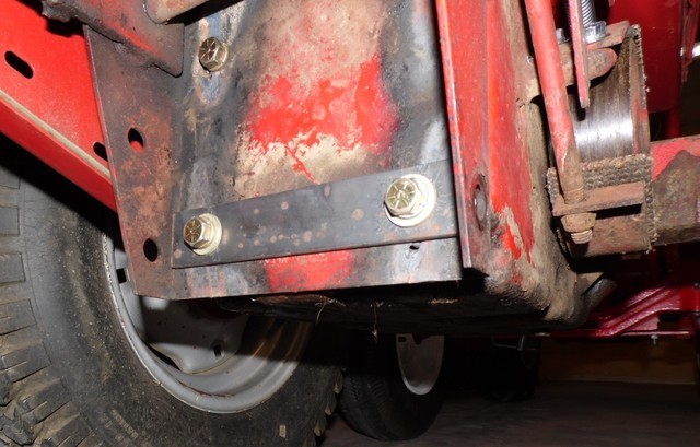

JoeD416 0 #14 Posted January 26, 2016 Hey got to take a real quick look at the tractor, the mount is fine snapped a pic after cleaning the grease off of it and then checked the bolts and all were tight, the drive belt does look like it was rubbing the guard on the out side next step would be to get the belt guard off I guess, the pulley for the belt felt tight like there are still balls in the bearing but I'm going to get the belt off and spin the pulley to check for roughness, anybody no a proper free play measurement for clutch adjustment? Or is a trial and error I've adjusted plenty of linkage clutchs on old cars and trucks just never on a horse!! Share this post Link to post Share on other sites

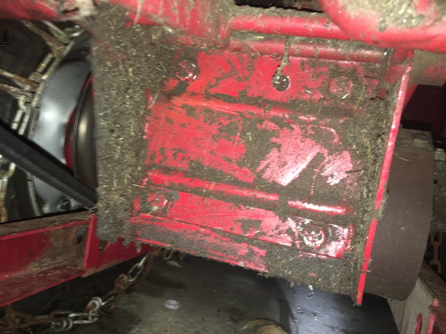

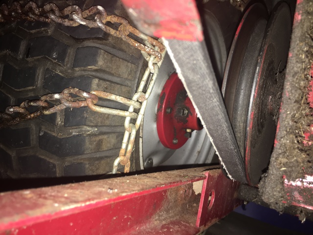

Ed Kennell 47,749 #19 Posted January 26, 2016 (edited) Looks like your plow frame is rubbing the pulley and belt. Edited January 26, 2016 by ekennell 2 Share this post Link to post Share on other sites
Kegler 68 #20 Posted January 26, 2016 I thought it looked like the edge of the belt might be rubbing the end of the belt guard (at top of picture) definable rubbing something. Share this post Link to post Share on other sites
