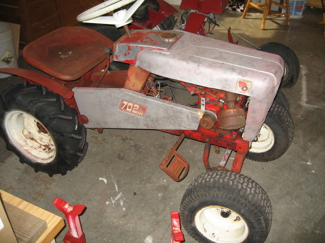

carlosking450 162 #1 Posted January 24, 2016 Hello I need you to tell me if this leak is original or amended this you can get a picture of an original escape and references to buy it . My model is a 702 wheel horse Share this post Link to post Share on other sites
WH nut 553 #2 Posted January 24, 2016 You need a new muffler, if you want to make it original you need to remove a couple of inches from the nipple 1 Share this post Link to post Share on other sites

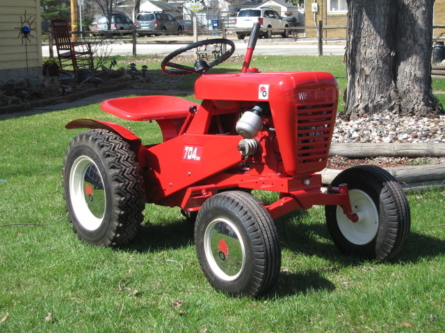

slammer302 2,157 #3 Posted January 24, 2016 Here's a pic of my dads 704 you can kinda see what the muffler looks like its slightly angled down and does not stick out to far 1 Share this post Link to post Share on other sites
carlosking450 162 #4 Posted January 24, 2016 10 hours ago, WH nut said: Se necesita un nuevo silenciador, si quieres que sea original, es necesario eliminar un par de pulgadas del pezón then the pipe coming out of the butt should be shorter it? Share this post Link to post Share on other sites

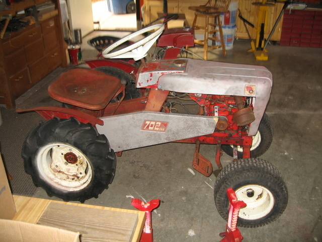

Shynon 7,730 #5 Posted January 24, 2016 my 702 when I got it and my 704 after restore, hope this helps 3 Share this post Link to post Share on other sites

RedRanger 1,470 #7 Posted February 5, 2016 On 1/24/2016 at 4:15 AM, carlosking450 said: Hello I need you to tell me if this leak is original or amended this you can get a picture of an original escape and references to buy it . My model is a 702 wheel horse Throttle cable is hooked up wrong too. It is not allowing the governor to operate. Good chance of blowing up that engine. Share this post Link to post Share on other sites

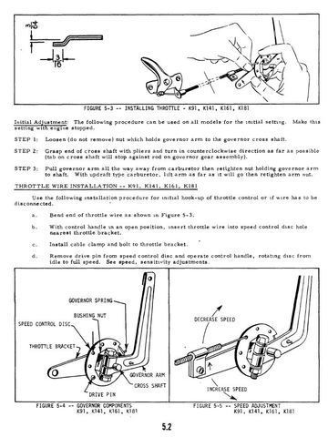

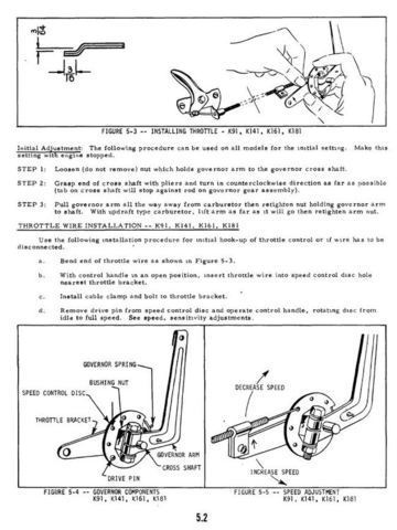

pfrederi 21,346 #8 Posted February 5, 2016 RedRanger is spot on. Your throttle cable is not hooked up correctly. This is from the Kohler manual Share this post Link to post Share on other sites
