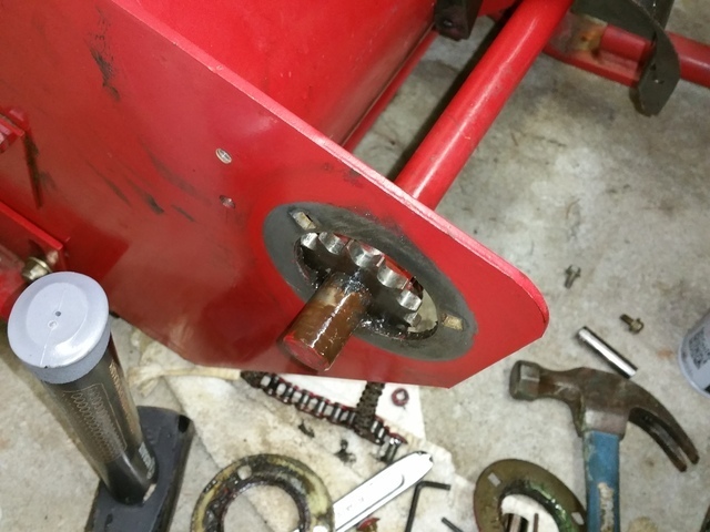

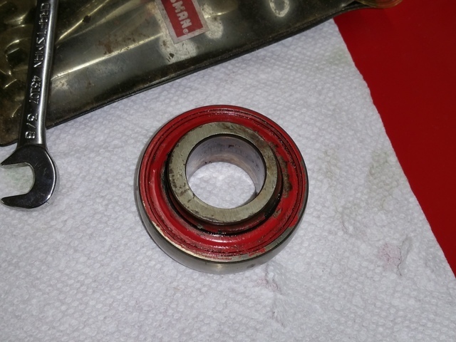

JERSEYHAWG / Glenn 4,534 #28 Posted January 28, 2016 (edited) ok. the repair is done. the bearing on the cross shaft chain sprocket side was the clunker. hard to turn felt gritty and worn. the pulley side one felt ok. but what the heck it was apart so both got replaced. the auger spun free as could be with the touch of a finger. chain sprockets were good. free. good points. so didnt touch anything there. back up and running. end of story. Glenn Edited January 28, 2016 by JERSEYHAWG / Glenn 3 Share this post Link to post Share on other sites
Kurt-NEPA 756 #29 Posted January 28, 2016 Yeah! Now you are an expert on cam lock bearings. Glad you found the culprit and the blower is ready for the next Nor'easter, if we ever get another. Kurt 1 Share this post Link to post Share on other sites

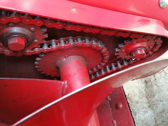

WHX?? 55,701 #30 Posted January 28, 2016 I take it you checked those ildler sprockets Glenn...looks like the seals are starting to cup out on them? Chain is lookin a little dry too, I spray chain lube on it while it's rotating at idle. Ran out of chain lube last time so just drizzled some 80 weight on it. 1 Share this post Link to post Share on other sites
JERSEYHAWG / Glenn 4,534 #31 Posted January 28, 2016 23 minutes ago, WHX6 said: I take it you checked those ildler sprockets Glenn...looks like the seals are starting to cup out on them? Chain is lookin a little dry too, I spray chain lube on it while it's rotating at idle. Ran out of chain lube last time so just drizzled some 80 weight on it. the idler sprockets are good. the chain picture was taken before I took it apart. just as a reminder of how to route it on re assembly. trust me its not dry now. Its got plenty of lube on it. that chain was new last season .........I do the chain lube / drizzle trick to. Glenn 2 Share this post Link to post Share on other sites
WHX?? 55,701 #32 Posted January 28, 2016 3 minutes ago, JERSEYHAWG / Glenn said: as a reminder of how to route it on re assembly Funny you should say that....I put it back on five times wrong before i figured it out.... 2 Share this post Link to post Share on other sites
squonk 45,805 #33 Posted January 28, 2016 Funny story about those cam locks. I was working 2nd shift. as I arrived 2 old time guys ( and I mean old timers) were working on a fan trying to get the bearings off of the shaft. They were a beatin and a bangin with a hammer. They told me they have been at it over an hour. Had the torch out and were ready to cut them off. I knew about cam locks brgs. from my days at Napa. I grabbed a punch and hammer and un-locked the collars and the brgs. fell off. They both looked at me with their jaws on the floor! 6 Share this post Link to post Share on other sites
