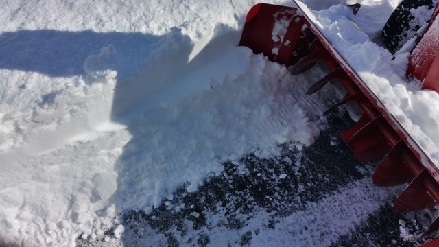

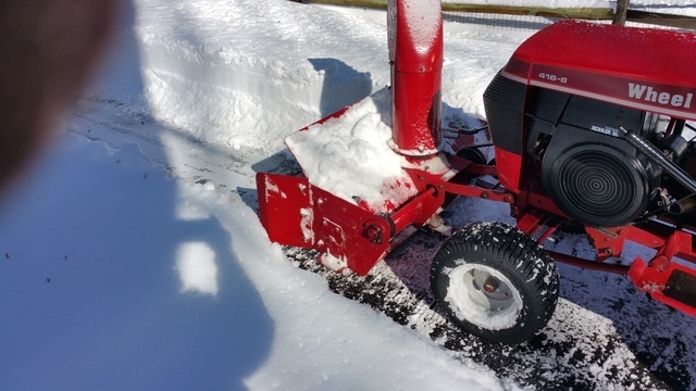

JERSEYHAWG / Glenn 4,578 #1 Posted January 23, 2016 Ok, so after the big snow battle today. And, btw, I have to battle again later cause its still coming down. I start getting a high pitch whine from, probably, the auger bearing on the chain drive side. Ok, my fault, I should have changed out all this stuff before the season, right? But who fixes what ain't broke. Not me. I just hope this thing don't crap out and let me finish this cleanup. Anyway, who has figured out what THE BEST replacement bearings are to use? Anything with zerks? Or what's my choices. This will be a total overhaul end of season. The snow thrower has never had anything changed by me other than a new chain. Let's hear it guys,,,who knows what we got to use? Thanks group. Glenn,,,,from the blizzardy state of NJ 1 Share this post Link to post Share on other sites

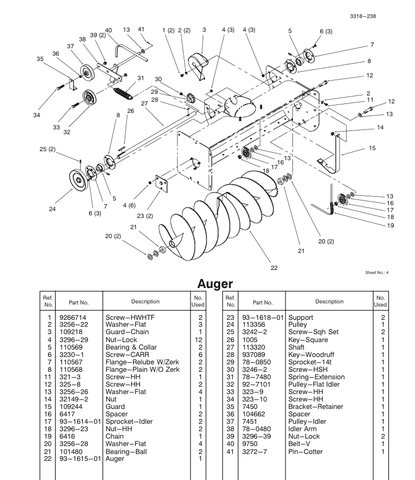

gwest_ca-(File Mod) 12,349 #6 Posted January 23, 2016 17 minutes ago, SPINJIM said: It's a single stage blower from around 1970. I looked at the exploded view in the manual, and it looks like there should be pin in the auger tube that would go through the shaft and maybe also part of the bearing assembly. The 'shaft' that goes thru the bearing is the one that is welded onto the height adjustment lever. But I don't see anything on the auger tube that would release that shaft. This may be the model you have The 6-9112 is the completeing kit to mount the above snowthrower on a long frame tractor. The left side wheel and arm is secured to the shaft that runs through the auger by one roll pin drove inside a second roll pin. Once they are out the shaft should go out the right side. Garry 1 Share this post Link to post Share on other sites

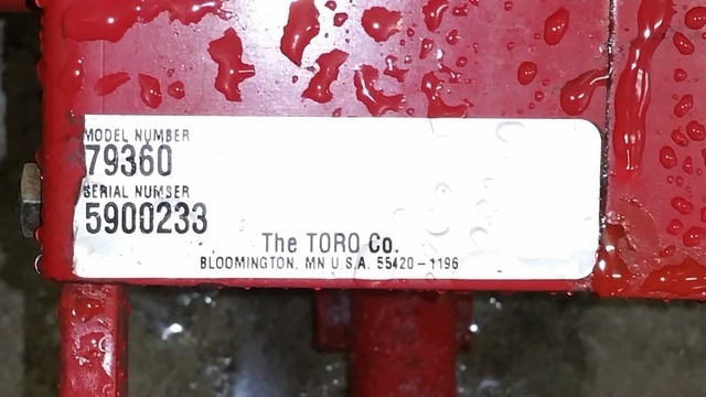

JERSEYHAWG / Glenn 4,578 #7 Posted January 23, 2016 (edited) hey there mr Garry. you have anything for my model so i can take a look see? thanks. Glenn Edited January 24, 2016 by JERSEYHAWG / Glenn Share this post Link to post Share on other sites
WNYPCRepair 1,924 #8 Posted January 23, 2016 (edited) 4 minutes ago, JERSEYHAWG / Glenn said: hey there mr Garry. you have anything for my model do i can take a look see? thanks. Glenn Edited January 23, 2016 by WNYPCRepair 1 Share this post Link to post Share on other sites

SPINJIM 1,997 #10 Posted January 23, 2016 16 minutes ago, gwest_ca said: This may be the model you have The 6-9112 is the completeing kit to mount the above snowthrower on a long frame tractor. The left side wheel and arm is secured to the shaft that runs through the auger by one roll pin drove inside a second roll pin. Once they are out the shaft should go out the right side. Garry Sorry, I had a brain freeze. The Snow Thrower is 6-6212 as you figured. I'll look again for the roll pin. Couldn't find it first two times, but maybe it's painted over flush with the auger tube, or maybe it's farther toward the center of the auger than I thought. Thanks for the great help. Jim Share this post Link to post Share on other sites
gwest_ca-(File Mod) 12,349 #11 Posted January 24, 2016 1 hour ago, SPINJIM said: Sorry, I had a brain freeze. The Snow Thrower is 6-6212 as you figured. I'll look again for the roll pin. Couldn't find it first two times, but maybe it's painted over flush with the auger tube, or maybe it's farther toward the center of the auger than I thought. Thanks for the great help. Jim The roll pins are in the arm that holds the wheel on the left side - right at the very end outside the snowthrower. Garry Share this post Link to post Share on other sites
Kurt-NEPA 756 #12 Posted January 24, 2016 (edited) 3 hours ago, JERSEYHAWG / Glenn said: Hi Glenn, Which bearing is complaining? From my notes, the bearings are as follows Auger Shaft - 1630-2RS Jack Shaft - SA205-14 Both are common bearings and not too difficult to change out. I usually get my bearings from USA Bearings and Belts. Kurt Edited January 24, 2016 by Kurt-NEPA 2 Share this post Link to post Share on other sites
JERSEYHAWG / Glenn 4,578 #13 Posted January 24, 2016 3 minutes ago, Kurt-NEPA said: Hi Glenn, Which bearing is complaining? From my notes, the bearings are as follows Auger Shaft - 1630-2RS Jack Shaft - SA205-14 Both are common bearings and not too difficult to change out. I usually get my bearings from USA Bearings and Belts. Kurt Hey Kurt, I can't tell which one. I figure to just replace them all. I will post when I find out the culprit for sure. Thanks Glenn Share this post Link to post Share on other sites

doc724 927 #18 Posted January 24, 2016 If you want to know which bearing is complaining, after you have finished blowing and the machine is shut off, remove your gloves and touch all the bearings. They might be warm, but the bad bearing may be really hot. Check all of them to get a feeling as to what is normal. Getting the auger bearings out is easy. Remove the three nuts on each stub shaft and remove the stub shaft. Leave the auger in place. Take a 1/2' diameter, 4ft long pipe or wood dowel and put it thru the bearing on one end until it hits the bearing on the far end and whack it. Bearing and two spacer washers should pop right out. Repeat on the the end. Save the spacer washers (new bearings from Toro come with the two washers, aftermarket bearings do not). New bearing will slide right in with a very light tap. Put both spacer washers on the stub shaft and tighten the nuts. Make sure you use both spacer washers on each end of the auger will float side to side. 2 Share this post Link to post Share on other sites

JERSEYHAWG / Glenn 4,578 #23 Posted January 25, 2016 6 hours ago, squonk said: I'm betting it's a cross shaft bearing. Take the chain off and you'll find it. Ok, my brother came over with his heat gun. After running the snowthrower, the auger bearings were 35 / 40 degrees + -. The bearing on the shaft with the chain attached to it was 90 degrees + -. The pulley bearing with the drive belt on it was 107 degrees + -. So there are the 2 culprits giving me the trouble. I never thought of the heat gun, cause I don't have one. Also, my cutting edge is getting worn, don't want it getting into the auger housing. Can that be flipped? If it cant, where can I get one? Thanks for the replies also. Now I need to get 2 GOOD bearings and get them replaced. After all winter is only one third gone. Glenn 2 Share this post Link to post Share on other sites
squonk 47,379 #24 Posted January 25, 2016 Before you get those bearings I would still pull that chain and inspect the sprocket bearings closely. I have the same blower which when I got it looked hardly used. But those sprockets were shot along with the cross shaft bearings. The chain has to come off anyway to do the cross shaft so might as well get what you need in one shot. 1 Share this post Link to post Share on other sites
