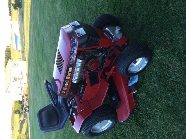

richmondred01 2,393 #54 Posted January 25, 2016 Per previous post. Nothing wrong with the hydro unit. I just was expecting too much from the 520. I went from the Cubs to the 520. Not really a fair comparison. But once again I expected more. 2 Share this post Link to post Share on other sites
pfrederi 21,150 #55 Posted January 25, 2016 53 minutes ago, richmondred01 said: Per previous post. Nothing wrong with the hydro unit. I just was expecting too much from the 520. I went from the Cubs to the 520. Not really a fair comparison. But once again I expected more. You went from 60 cubic inch 4 cylinder to about to 47 ci 2 cylinder. Your cub (later ones anyway) were 15hp at the draw bar the "20hp" 520 was a gross hp at teh engine crank shaft. Hydros them selves are not a efficient as gear type. Then there is the weight and tire size.Your cub is at least 3 times the weight of the 520 if not 4 times. If snow plowing was the prime chore I would have stuck with the cub. It is like comparing my Wheel Horse D200 to my Case VAC they are both 20 hp (but rated differently). The VAC would drag teh D200 all over and plows snow a lot better. Apples vs Oranges 3 Share this post Link to post Share on other sites
richmondred01 2,393 #56 Posted January 25, 2016 Actually the red one is 11 hp and the yellow 13 hp. And yes I know I'm comparing apples to oranges. I know better next storm. Need a blower or get the 8 speed 314 up and running. 1 Share this post Link to post Share on other sites
SAM58 34 #57 Posted January 25, 2016 Something bad wrong with your tractor or someone has worked on it and didn't use the correct Filter, oil or you bought one with a tranny going bad. Mine is a beast!! i can run it up against a tree & it keeps digging. Can't stall one that is in good working order. We had 20" snow storm over the weekend and I pushed snow for about 12 hours the last two days for me and about 5 neighbors. Chains, No wheel weights. Use: 10W-30 Premium Motor oil for the Hydro (5 Qts if drained properly) WIX Filter 51410 (without the check valve in it) I think you have the wrong filter & its starving for fluid. See the pictures, First passed almost made it to the bottom, but you can see the mound of snow in front. moved it and had no problem after that. Second & third was end results, Last picture is a neighbors driveway 200 + feet long I plowed for a widow woman, about an hour or so... 10 minutes ago, richmondred01 said: Actually the red one is 11 hp and the yellow 13 hp. And yes I know I'm comparing apples to oranges. I know better next storm. Need a blower or get the 8 speed 314 up and running. Where can I find a Belt Guard with the vent holes like yours?? 2 Share this post Link to post Share on other sites

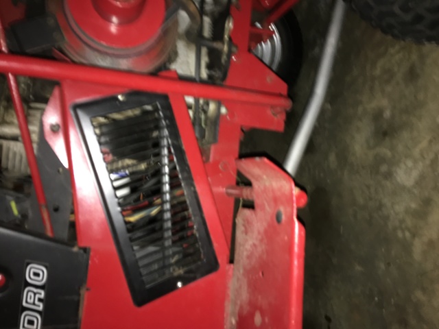

cheesegrader 436 #58 Posted January 25, 2016 I was going to mention the same thing. Nice guard mod. It also looks like you have the 5-hole index on the blade angle selector, and an unusual handle set-up. Someone has put a little extra effort into that horse. 1 Share this post Link to post Share on other sites
New wheel 23 #59 Posted January 25, 2016 (edited) This was my answer for a vented belt guard. Bought a floor vent cover, cut a rectangle in the guard and screwed it fast. Edited January 25, 2016 by New wheel Clearer picture. Just got home and took it 3 Share this post Link to post Share on other sites
WNYPCRepair 1,924 #60 Posted January 25, 2016 45 minutes ago, cheesegrader said: I was going to mention the same thing. Nice guard mod. It also looks like you have the 5-hole index on the blade angle selector, and an unusual handle set-up. Someone has put a little extra effort into that horse. Looks like how I had to set my handle up because I don't have the extension kit. Looks like the same clearance at front wheels too Share this post Link to post Share on other sites

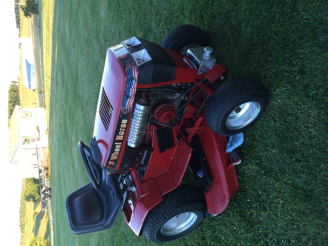

richmondred01 2,393 #69 Posted January 28, 2016 52 minutes ago, can whlvr said: nice lookin 520 and the plow looks brand new It was new. I got it from a guy who cut 3 acres a week with it. I had all the receipts since it was new. He was moving to a smaller place. Never used the blade. He Took it to the dealer every fall and had any repairs done and serviced. When I got it I pulled the engine put rings along with new valves just for preventative maintenance. Then I modified the belt guard. Share this post Link to post Share on other sites
