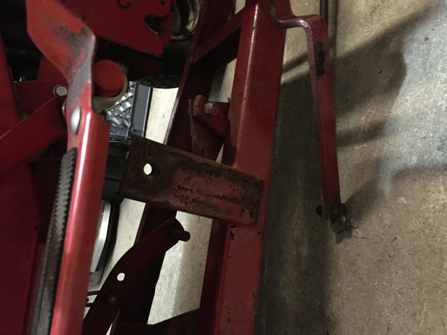

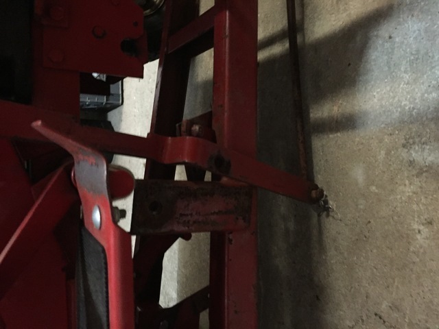

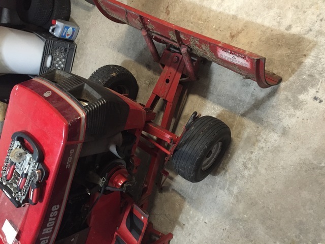

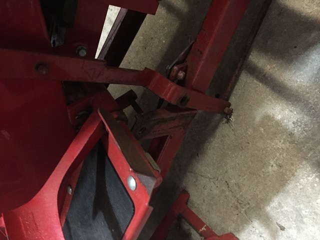

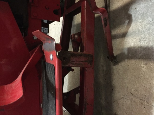

jeremygibbs42 3 #1 Posted January 23, 2016 Hi I recently acquired a dozer blade 42BC01 for free. I believe it is the 42" blade. I currently own a 312-8 and attempted to attach the blade however it seems that it is "too short." The bracket which mounts the handle to change the direction of the blade seems to be directly under the right foot rest/brake pedal side. I attached the blade to the rear and can only assume that the blade is too short. Does anybody know if the 42BC01 will fit the 312-8 or if there is anymore information I need to get to see if it will fit. Thanks Share this post Link to post Share on other sites

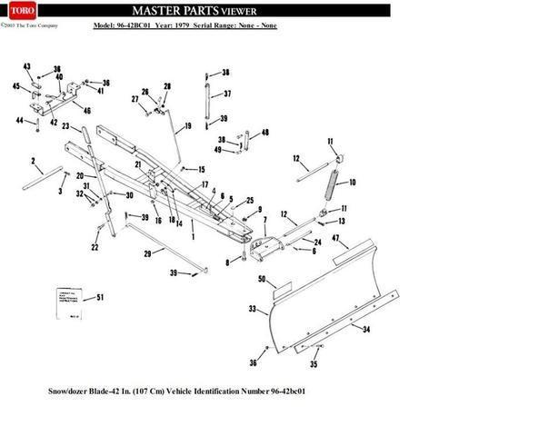

WNYPCRepair 1,924 #2 Posted January 23, 2016 (edited) Pictures of the plow and frame would help. Does the frame look like this, and if so, it appears the bar for the back hitch can go in either set of holes. I am just going by the diagram, so I could well be wrong Edited January 23, 2016 by WNYPCRepair 1 Share this post Link to post Share on other sites
squonk 47,898 #3 Posted January 23, 2016 Yes, make sure bar #2 is in the back set of holes. 1 Share this post Link to post Share on other sites

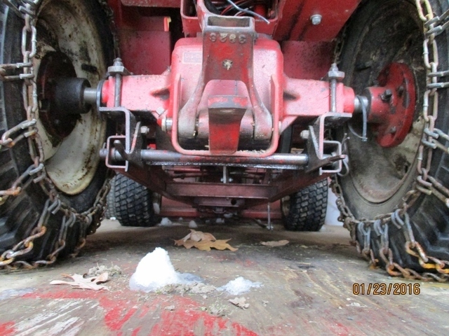

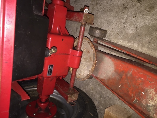

jeremygibbs42 3 #9 Posted January 23, 2016 Hi Guys, I posted some pics. You can see where the that bracket is just under the foot rest. Thanks for any advice!! Share this post Link to post Share on other sites
doc724 927 #10 Posted January 23, 2016 You have the plow mounted incorrectly. You need to have the rear tach a matic hitch (item 46 in WNYPC repairs posting) which mounts to the rear axle. The plow does not go into the transaxle where the rear tow hitch goes 5 Share this post Link to post Share on other sites

varosd 1,185 #13 Posted January 23, 2016 you need one of theses to mount to the real axle then the rear rod of the plow frame locks up into it. How did you get the rear to hook up up the way you did? 1 Share this post Link to post Share on other sites

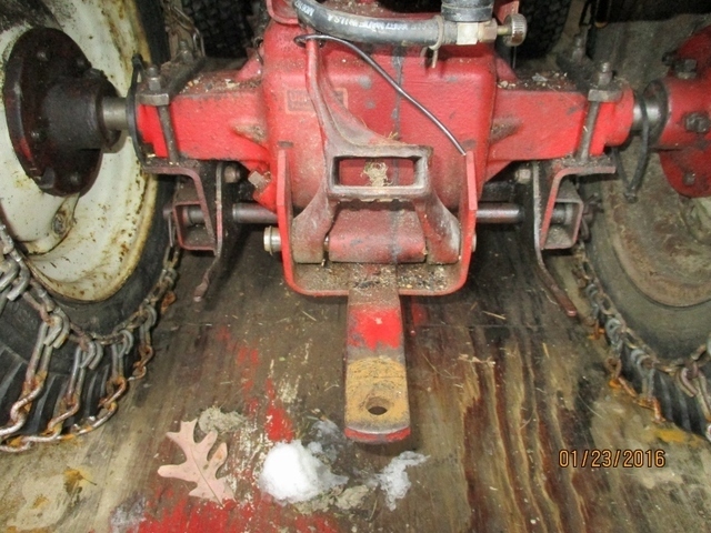

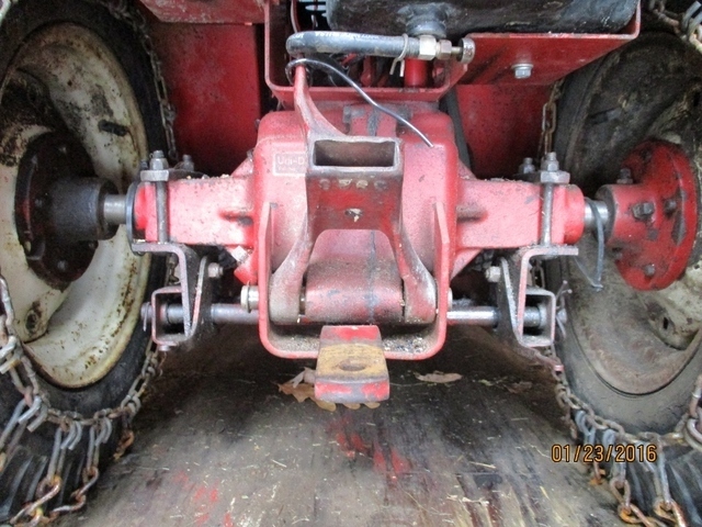

N3PUY 1,031 #15 Posted January 23, 2016 here's some pics 4 Share this post Link to post Share on other sites
jeremygibbs42 3 #16 Posted January 23, 2016 Thanks everyone, I see the bracket that I am missing. Do you guys know if there is anywhere I can get one. Or just look on eBay? Or a model number for the rear mounting bracket? Share this post Link to post Share on other sites
