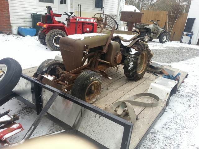

d -bunked 6 #1 Posted January 22, 2016 Just picked this up, can anyone tell me what year and model it is? 3 Share this post Link to post Share on other sites
AMC RULES 37,260 #2 Posted January 22, 2016 Not sure which...but, based on that engine, I'm pretty confident it's one of these guys here. 550 1960 Lawn & Garden Tractor Surburban 4-Speed Tecumseh H55B-1170 5.5 Wheel Horse 5010 551 1961 Lawn & Garden Tractor 551 4-Speed Tecumseh H55D-2113 5.5 Wheel Horse 5007502 1962 Lawn & Garden Tractor 502 4-Speed Tecumseh HT55C-3088 5.5 Wheel Horse 5025552 1962 Lawn & Garden Tractor 552 4-Speed Tecumseh HT55C-3089 5.5 Wheel Horse 5025 Share this post Link to post Share on other sites
d -bunked 6 #3 Posted January 22, 2016 thank you i will try 2 narrow it down very big help 1 Share this post Link to post Share on other sites
AMC RULES 37,260 #4 Posted January 22, 2016 H55B-1170 H55D-2113 HT55C-3088 HT55C-3089 Check and see if you can find any of these numbers on the engine. Share this post Link to post Share on other sites
d -bunked 6 #5 Posted January 22, 2016 going 2 start 2 tear it down I will look 4 numbers on engine thanks Share this post Link to post Share on other sites

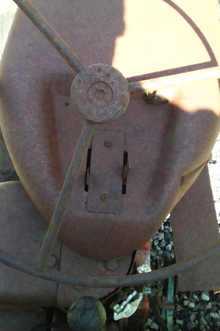

RedRanger 1,470 #6 Posted January 22, 2016 Engine won't tell you much about the tractor model. Looks like a replacement engine to me. The recoil looks like it's from the 70's and it looks like a Briggs, which I don't think even came factory on these. Solid firewall means it wasn't an electric start either. Also looks to have the earlier foot pads and 1960 brake pedal. Can you post up a picture of the throttle/choke levers and a picture of the rear end? I'm betting it's a 1960 400. Also looks like a solid seat pan which would be early 1960. 1 Share this post Link to post Share on other sites
953 nut 70,330 #7 Posted January 22, 2016 Looks like it is a 400 or 401, show us a photo of the hood from the driver's end so we can see the throttle/choke set up. 2 Share this post Link to post Share on other sites

WHX?? 58,347 #10 Posted January 22, 2016 Suburban fer sure...My money is on it being an early '60 400....a zoom in on it there looks there might be the two levers minus the handles on the dash, solid seat pan. Definitely not a Clinton which might have have been on it but not a Kohler either.. 1 Share this post Link to post Share on other sites

formariz 12,381 #15 Posted January 26, 2016 (edited) Its a 1960 Suburban 550. It has the solid hood stand. Hood should have the slide throttle and choke controls. Engine should be Tecumseh /Lauson H55. Carburater should be a downdraft Tillotson. Edited January 26, 2016 by formariz 1 Share this post Link to post Share on other sites

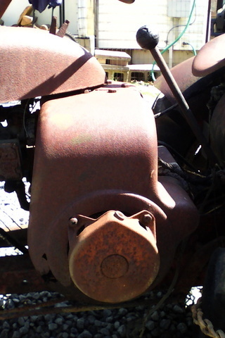

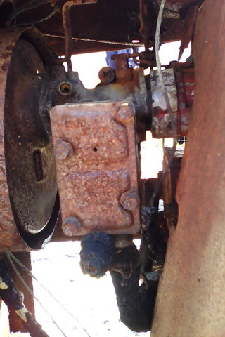

d -bunked 6 #17 Posted March 27, 2016 here are more pics 2 figure what year and model sorry it took so long work gets in the way of all my fun 2 Share this post Link to post Share on other sites
wallfish 20,733 #18 Posted March 27, 2016 Formariz hit the nail on the head -- 1960 550 The 400 and 550 are the same exact tractor with a solid firewall but they used different engines. 550 would just have the extra stuff for the electric start A 400 would've had a Kohler K91 and a few were made with a Clinton B1290. Both pull starts A 550 would be electric start with a Lauson/Tecumseh H55 and the key would be just where yours is. I'm going with a 550. Of coarse it is always possible someone could've changed engines from a Kohler to a Lauson but it would still be factory correct. 3 Share this post Link to post Share on other sites
