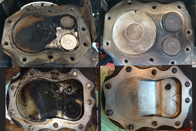

Al C. 1,474 #33 Posted May 24, 2016 Well, it has been four months since the last update to this thread. I decided not to purchase a "test" engine. Instead, I've been reading the manuals and watching many videos. Yesterday I opened up the SK-486 cylinder head, cleaned things out, replaced the head gasket and spark plug. It was pretty dirty inside, but there were no major gaps or fit variances. The engine ran smoothly with plenty of power before the maintenance and runs the same afterwards. It does startup faster after cleaning and I've been able to adjust the carborator leaner since the maintenance. Overall I feel great that I've inspected the engine, it is in good condition, it's clean, and runs like a champ. See the attached before-and-after picture. Next week I'll do the same to the 1067. Thanks to everyone on this thread for giving me the confidence and approach to trying this out. Al. 4 Share this post Link to post Share on other sites
WHX?? 58,181 #34 Posted May 24, 2016 4 hours ago, Al C. said: and I've been able to adjust the carborator leaner since the maintenance. Just be careful with that Al. engines running leaner tend to run hotter. 1 Share this post Link to post Share on other sites
