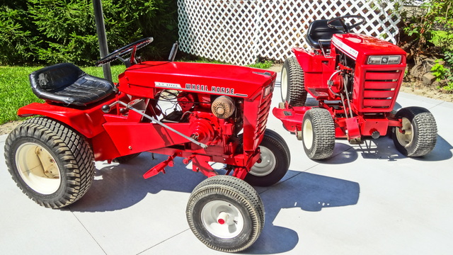

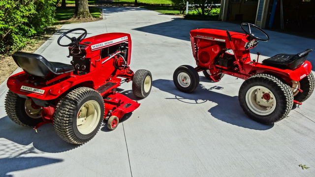

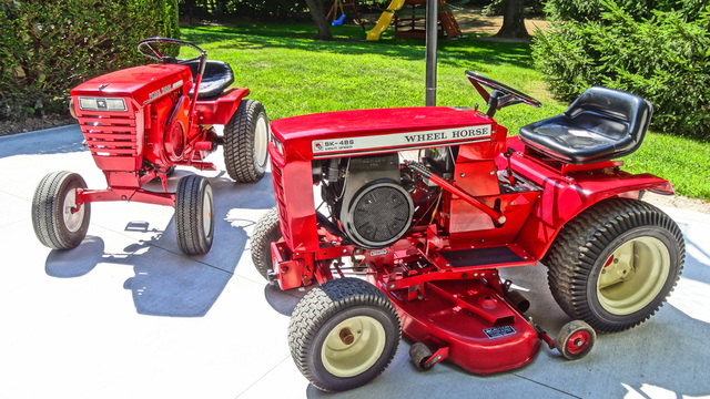

Al C. 1,480 #1 Posted January 21, 2016 I've been a member of the forum for about a year. In that time, I've restored a 1067 and purchased a SK-486 in mint shape (each has about 1,200 hours - all original). I'm pretty proficient with refinishing, electrical, and taking things apart and getting them back together again. Fortunately, both of tractors have very solid engines and eight speed transmissions. But, I fear the day something goes wrong in one of these areas. I have never opened an engine or transmission and have no experience in these areas. I am thinking of buying an old Kohler engine just to play with for this purpose. I'm wondering, will this make it easier for me, the day something does go wrong? Or, am I just as well off waiting until something happens and figuring it all out then? Would appreciate some experienced opinions. 11 Share this post Link to post Share on other sites
