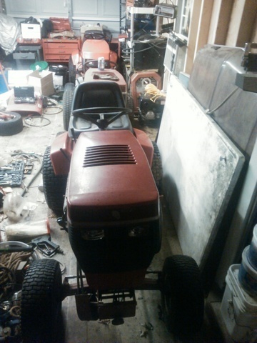

Docwheelhorse 2,993 #1 Posted January 21, 2016 Hello all, Sparky and I worked a deal for a 417a with a nice KT17 series II---rest of tractor is plain beat.... I happen to have a 418A that's nice with a blown motor.... plan is to merge the two into one awesome ride---complete with the forward splayed gear reduction steering setup I got from Stevebo. Plus my FEL and a Brinly hitch out back. Well they have both been outside and I decided I had better move them into the workshop before this snow either hits or doesn't hit this weekend. I tried to start the 417 but it had no spark, went and got screwdriver and took off cover. Scratched points and then jammed sandpaper in them... still couldn't get spark.... took points out and cleaned them inside and re-installed them. Ahhhh got spark! Motor fired up.... yes I was in the dark with a flashlight. Noticed a bit of smoke on the muffler and started looking around... DID YOU KNOW THAT THE POINT COVER SCREW CLOSEST TO THE PTO IS DRILLED CLEAR INTO THE OIL GALLEY!!!! That's right... as its sitting there running there was oil gently trickling out of the hole and getting blown onto the muffler.... not a violent spray but enough that I could tell it was under pressure. Yah it doesn't matter and I screwed the bolt into the hole to drive the tractor in the shop. Just found it weird.... Well... the GT1600 (needs a starter and hubs tightened etc...), the 417A--good motor bad everything else and the 418A---bad motor good everything else is all now in the shop and I plan an spending some quality time out there. Tony 4 Share this post Link to post Share on other sites
