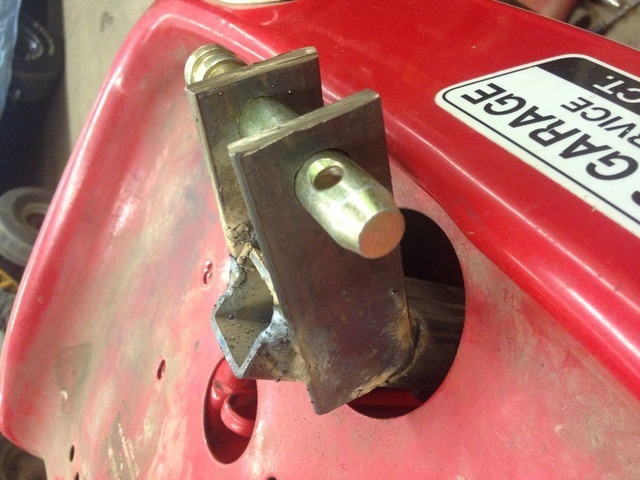

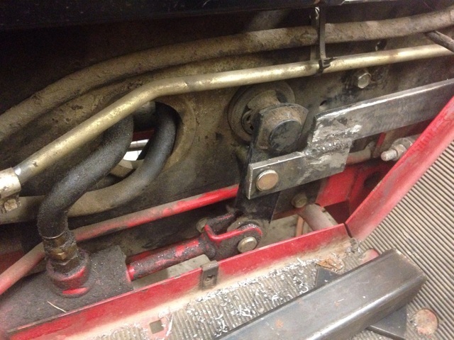

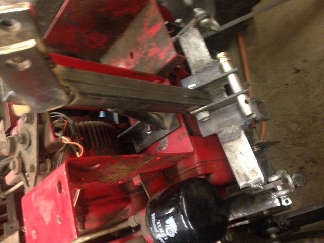

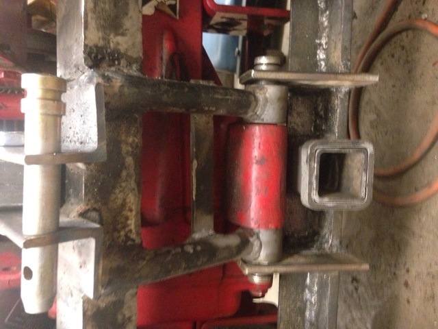

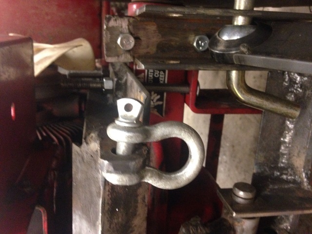

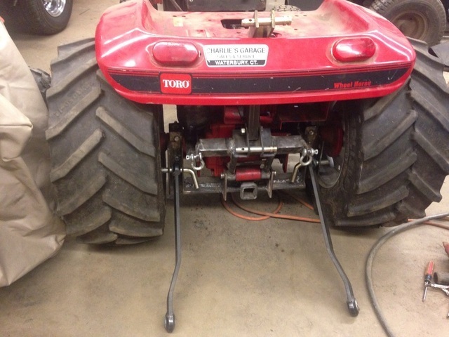

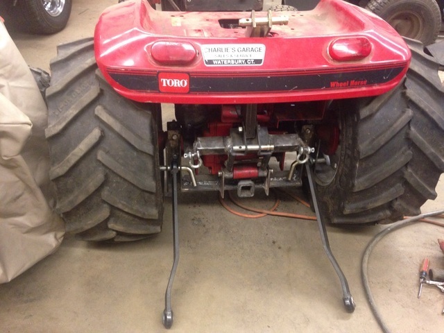

						I decided I needed a way to carry some things around when working with the tractor. This is not a "Wheel Horse" attachment, but will work with any Category 1 three point. The idea came from a Kubota guy that did some great videos on how to make it.

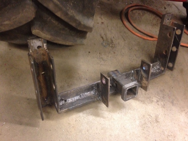

	I decided to go with a Rural King "King Kutter" frame for three reasons: 1) it was red and I didn't have to repaint it to match, 2) I liked the RK mounting points better than TSC because they were mounted away from the frame farther and accept quick hitch if you use that, and 3) out of three TSC location around me, NONE had thier County Line carrier in stock. RK had three for the same price of $159.
	I added a hitch receiver to move utility trailers. I beefed it like the video by adding a piece of steel and routing out the underside so it sat flush. For chainsaw carrier I routed out a 2x6 enough to fit the saw bar.
	My rear tires are water filled, but this adds a little more weight as well. I plan to get a big HF (1K) furniture dolly to put under it when not attached because it's too heavy to slide around. I can get that for $12. A handmade one cost more than that in just wheels.
	Here are some pictures of the build if you could use something like this.
