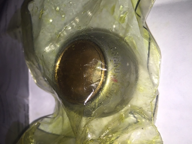

WNYPCRepair 1,924 #4 Posted January 21, 2016 (edited) The sprocket to adjust is (from driver's seat looking forward) is at bottom right. Loosen the bolt, and move it to the right. The hole is slanted a bit. Easiest way I found was a 3/4" square piece of wood cut a bit longer than the distance between the left side of the sprocket and the left side of the blower frame. Tap it in until the chain is tight, then tighten the sprocket nut. The auger bearings are not what I would call a bearing, more like a bushing. I have pics of my old ones somewhere, they have some type of fiber, cloth, or leather inside. I'll see if I can find them. Can't find the pics of the old ones, but here is a new one, and part numbers for them, and also the bearings up top on the jack shaft. That is the cheapest I found, but I'm sure someone here knows someone with a better price Edited January 21, 2016 by WNYPCRepair Share this post Link to post Share on other sites

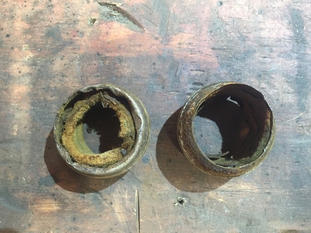

WNYPCRepair 1,924 #7 Posted January 21, 2016 Ah, here we go This is a topic with info on changing the auger bearings And a pic of the destroyed bearings on mine. I had to drive them out of the flanges with a punch, but they were already destroyed, all I did was bend the very edges a little, the rest was as I found them. And the auger still turned, by the way 4 minutes ago, Xearl said: Thank you Brian you are a big help . I should have checked all this before mounting the blower . ED Yeah, it is a hassle taking it on and off. I unhokked mine at mid mount and the rear axle braces, pulled the belt off the pulley and rolled the tractor back as far as I could, and did everything like that. And then did it again after Shallow Water Sailor pointed out the flanges were on wrong. Share this post Link to post Share on other sites
