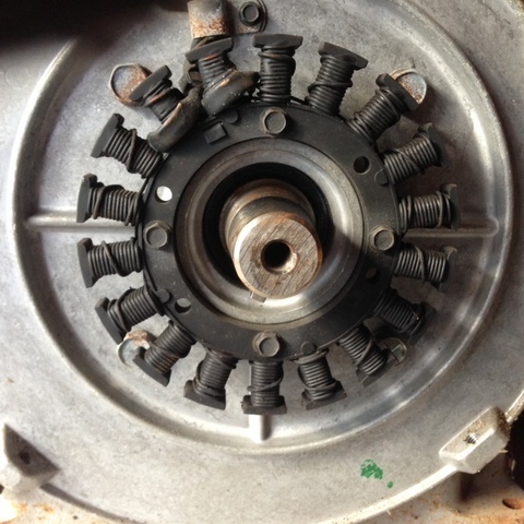

formariz 12,379 #1 Posted January 19, 2016 Can any one verify if this is a 25 amp stator. It is in a NOS K301 and specs lead to it being a 15 amp one. However since it has winding's on all legs according to manual it should be a 25amp unit. Share this post Link to post Share on other sites
Don1977 606 #2 Posted January 21, 2016 (edited) It's a 15 amp I have one just like it off a 1977 Wheel Horse. I was going to put up a picture but Photobucket is temporary down. Here's mine. Edited January 21, 2016 by Don1977 Share this post Link to post Share on other sites
formariz 12,379 #3 Posted January 21, 2016 (edited) Thank you. Just wanted to make sure before I put a 15 AMP rectifier to it and burn that. Some of the stuff you read in the manuals is much confusing or contradictory between them. I have to say that yours is prettier. Edited January 21, 2016 by formariz Share this post Link to post Share on other sites

formariz 12,379 #7 Posted February 4, 2016 The 15 amp stator have 18 posts, but only 16 are used (wrapped with wire) and has 2 wire leads (or connectors). The 25 amp stator have 18 posts, all of them are used and have 2 wire leads. The 30 amp stator have 12 posts, which are wrapped heavily with wire and have 4 wire leads. So after much research I come to the conclusion that indeed I have a 25 AMP stator. The Puzzling thing to me is that you find all kinds of stators selling new out there advertised as 15 AMP and if one follows Kohler and other expert sites out there they are 25AMP. Not that it matters to me what amperage it is, I just want to have the right rectifier for it and not damage the rectifier or stator and perform as it should.. If experts are correct then many 25AMP stators out there are running a 15AMP rectifier. Most of them from what I see. That raises more questions for me such as; Can then a 15 AMP rectifier be used with a 25AMP stator without damage? If so is it then charging battery at a reduced rate? Share this post Link to post Share on other sites
