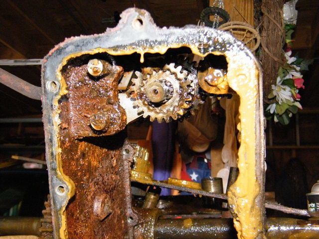

stevasaurus 23,662 #26 Posted January 17, 2016 Well stated Kasey. My ACE hardware carries the washing soda, and like I say...if you do not mess with the solution your shrubs or trees will love the solution when you decide to dump it. Remember you do not have to immerse the whole part in the solution, so your E-Tank may work if you can at least get 1/2 of a part in. That link I put up there puts a 55 gal tub on it's side and cuts a 1' stretch from top to bottom so you can work larger parts. I will be doing a little E-Tanking myself, when it warms up a bit. I have a rusted casting for a 3 piece transmission that I am going to E-Tank before I try to force the shift rails. This will be in a thread I have in Transmissions. Of course, I will get all the oil and goop out of there first. This will fit in a 5 gal bucket...1/2 at a time. 1 Share this post Link to post Share on other sites
kasey54 305 #27 Posted January 17, 2016 Wow, that looks like a challenge! How will you pre clean it? Some good cleaning solvent? I hope you post the results, I'll be following this. 1 Share this post Link to post Share on other sites
woodchuckfarmer 333 #28 Posted January 18, 2016 I use a Rubbermaid 120 gallon stock watering tank. Works great, can do a 48 inch deck in two shots. 1 Share this post Link to post Share on other sites
stevasaurus 23,662 #29 Posted January 18, 2016 kasey...I will scrape as much out as possible. Then a bit of diesel fuel in a bucket will get the rest of the gunk and oil. The gunk tank with a spray nozzle will get the rest of the oil and slop that is left. Then the E-Tank will eat all the rust in about 2 days and free up the shift rails and the casting will look like brand new. Boom-Sha-Ka-lac-a...a good casting again and the start of a RJ trans re-build. I've seen worse and ended up with a good transmission. E-Tanks work great on cast iron. Here is the thread where the results will be posted... 1 Share this post Link to post Share on other sites

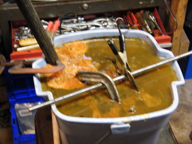

stevasaurus 23,662 #42 Posted January 19, 2016 I think you should just try the washing soda first and see how it works for you. This is in a 2 gallon pail. Parts are hanging by the "C" clamps. The anode is a piece of black pipe. As you can see, things are bubbling very nicely...parts cleaned in a day. Using 10 volt charger. 3 Share this post Link to post Share on other sites
