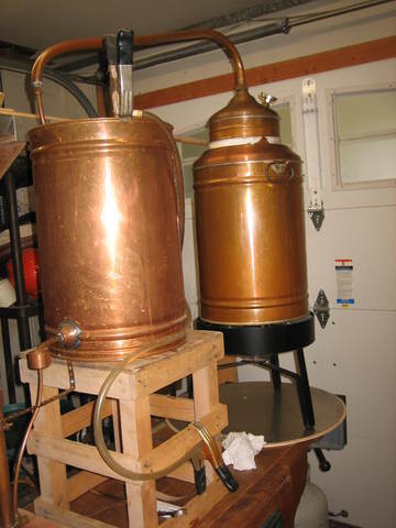

formariz 12,359 #13 Posted January 16, 2016 I have run into this issue in the past. I used an aquarium heater. It is submersible and it is not affected by anything in the tank since it is made out of glass and "chemical proof" plastic. It is also adjustable the better ones pretty much going to the boiling point. One will be sufficient for up to about 15 gallons. After that if it is real cold you may need more. 3 Share this post Link to post Share on other sites

formariz 12,359 #15 Posted January 16, 2016 On 1/13/2016 at 2:54 PM, stevasaurus said: I've had my tank freeze up (5 gal bucket)...think it was below 20 degrees Fahrenheit at the time. More Washing Soda is not going to do much of anything. Remember that this process gives off Hydrogen gas, which is explosive...you want to do this in a well ventilated area...which means that it will be hard to heat. Depending on the size of your container, you could put the container in a cardboard box, line the box with aluminum foil on the inside and use 1 or 2 100W light bulbs to heat the inside of the box. A small vent in the top should be OK and the temp may be held above 20 degrees. I am offering this as a suggestion. I have not tried this for electrolysis. I have used this process for making homemade wine. It is used to make Madeira...which needs to cook for about 4 months at around 130 degrees. The box is called a estufa, You can insulate the outside of the box with a blanket. Also remember that the tank only has to be large enough to hold what you want to take the rust off. Explosive, well ventilated area,Madeira, cooking..... I just don't understand the kind of foolish stuff you get into. 5 Share this post Link to post Share on other sites
kasey54 305 #16 Posted January 16, 2016 formariz, Great looking set up! Very nice. The aquarium tank heater is an excellent idea have to wonder why I didn't think of it , Thanks 1 Share this post Link to post Share on other sites
DennisThornton 4,773 #17 Posted January 16, 2016 14 minutes ago, russellmc301 said: i'm not trying to be dumb but what is a e-tank i looked it up and it it looks like an oxygen tank. what is it uses? Ton's on Google. (electrolysis tank "rust removal")! Rust removal with a hose and scrub brush! 8 minutes ago, formariz said: Explosive, well ventilated area,Madeira, cooking..... I just don't understand the kind of foolish stuff you get into. Well, you just started something! Samples for all members? What'd that copper set you back? Wonder what a copper Wheel Horse would cost? 1 Share this post Link to post Share on other sites

WHX?? 56,842 #20 Posted January 16, 2016 To answer your question Russell an e- tank is short for electrolysis tank wherein a container is filled with water and washing soda. A small voltage is a applied through electrodes (usually a battery charger for us home brews). The process will remove rust from horse parts. Will find alot more info on the net.....and here. I'm way to slow AMC has got it. The only dumb question is one that is not asked. Um ahhh Dennis.....I think that's Formariz' still....not an e tank... 4 Share this post Link to post Share on other sites
