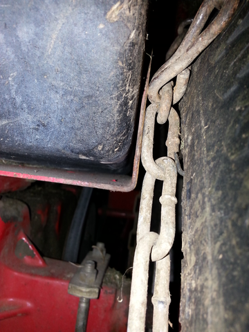

WHwest8597 85 #1 Posted January 12, 2016 I bought new Carsile Turf Master tires this summer and went to put chains on to plow and see that the chains hit the bracket for the gas tank. I have a 1996 314-8. Does any have this problem. do I need to go to a narrow size tire? Share this post Link to post Share on other sites
doc724 927 #2 Posted January 12, 2016 I have a similar problem. Last year I had the stock Dico 23x9.5-12 on my 1998 314-8. No problem with chains. This year I put Kenda 23x9.5-12 on my 1996 416H-big problem. The chains hit the gas tank bracket on the right and the pivot points for the brake on the left. So I am going without chains (fingers crossed) and lots of weight this year. The Kenda tires put more rubber on the road surface than the Dico tires There are three potential fixes that I know of; 1. Buy a cheapie spacer at Autozone or similar. The come in 1/4 inch and 5/15 inch thickness. Not an elegant solution but it works. 2. Get a set of wheels from a 1970's vintage tractor. The offset is different and will push out the tires away from the bracket. As a consequence it will make the rear track wider. 3. Get a narrower tire (or a narrower profile tire of the same size). Share this post Link to post Share on other sites

Tankman 3,528 #5 Posted January 19, 2016 (edited) Offsets on the rims, a pain. Picked up a like new pair of rear tires from a Simplicity. Too close to the tank, frame, all. Take a peek-a-boo at Xtreme's spacers. http://xtrememotorworks.com/Parts%20Catalog/Cub%20Cadet%20Parts%20Dual%20Wheel%20Spacers.htm Available in several heights (thicknesses). Edited January 21, 2016 by Tankman Share this post Link to post Share on other sites

Martin 2,135 #10 Posted January 20, 2016 the mid nineties tractors had the rear wheel offset different to the older tractors on the 12 x7 wheels. They are tight enough to cause that problem with chains. I dont know why they changed offset, but one way out would be to get earlier rear wheels. Not sure when they changed them, but any of the 60s and up to and including black hood c series would be the ticket. Tape measure on candidate wheels would confirm if you are getting the earlier offset. 1 Share this post Link to post Share on other sites

WHwest8597 85 #12 Posted January 23, 2016 I bought a set of spacers but will need some longer bolts. Does anyone have the size of bolt that was used for the hubs. Share this post Link to post Share on other sites
woodchuckfarmer 333 #13 Posted January 23, 2016 Wheel studs are 7/16 fine thread.--Wayne Share this post Link to post Share on other sites

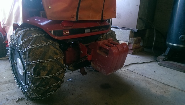

WVHillbilly520H 10,379 #15 Posted January 24, 2016 (edited) Not trying to tell you how to do things but maybe if the chains were not on inside out (cross bar end links "J" should be facing out not in towards the tires as in your picture...but using chains 30+ years on equipment and vechicles...check out the chains on my 520H Edited January 24, 2016 by WVHillbilly520H better picture 1 Share this post Link to post Share on other sites
