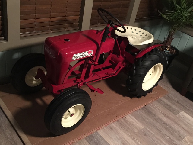

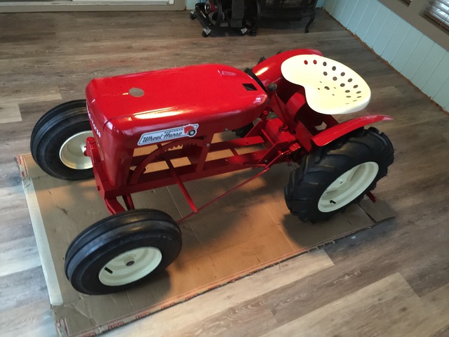

AlwaysLookin80 1,308 #8 Posted January 11, 2016 10 hours ago, AMC RULES said: Considering expansion, and contraction...don't think I'd clear over them. IMO, International Harvester red is the best duplicate of the original factory color on the earlier 's. 100% agree with this post. Here's mine I just finished, stickers right over the international harvester red with no clear on them. 3 Share this post Link to post Share on other sites
