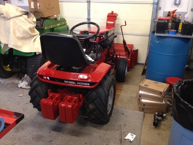

JAinVA 4,638 #9 Posted January 10, 2016 Doc 724 has introduced some valid points with figures to back the postion that carrying a weight rack on the bearings is not bad as presumed.I appreciate the information and feel better about loading the transaxle with weights.My basic experience is with larger and much heavier machines.These tractors carry most of their weights at the wheels by cast iron weights or loaded tires.I have seen pictures of WH's with what looks to be half a ton of weight hanging off the back. I cringe at the sight.They might be able to handle the load but I think that I will try to keep the off the transaxle bearings.I have to fix them if they fail.JMHO,JAinVA Jim Share this post Link to post Share on other sites

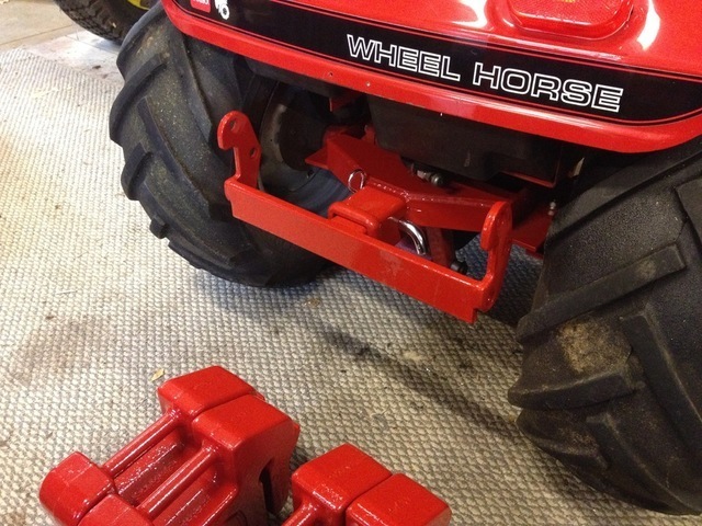

WNYPCRepair 1,924 #10 Posted January 10, 2016 I would be cautious in adding a bunch of weight hanging off the hitch though. I would worry about the hinged hitch (for lack of a better description) punching a hole through the transaxle on bumps. All the weight on the hitch will be concentrated on the small part of the hitch that rests against the transaxle, that can't be good 3 Share this post Link to post Share on other sites
SylvanLakeWH 31,824 #11 Posted January 10, 2016 Much appreciate the added thoughts and observations. Along with the dumb bells on my hitch, I may now need to pay attention to my wife and shed more than a few pounds around my own middle... Hey, at least I can blame radial load to the WH's transaxle... 1 Share this post Link to post Share on other sites

wallfish 20,246 #15 Posted January 10, 2016 5 hours ago, doc724 said: So I guess I would like to hear from RS members regarding their actual experience with respect to bearings or transaxles being damaged by cast iron wheel weights, loaded tires, suitcase weights, weight boxes. One of my tractors has a constant and continuous hanging load of about 500lbs off the back and haven't had any issues with the trans so far after 6 or 7 years. (8 speed with 1 1/8 axles) Only problem I had was snapping an axle while using dual 10.5 wide tires on it. 4 Share this post Link to post Share on other sites
Sparky-(Admin) 25,988 #16 Posted January 10, 2016 I believe in loading the rear rims with weight for snow-plowing traction. I don't have fancy facts and figures to back up anything I say....its only my opinion... but nothing last forever and everything wears out at some point if its being used (even our beloved WH's). So in theory an axle bearing with less load and proper lubrication should outlast the same bearing with proper lubrication and more load. Wall fish has a back-hoe hanging off his machine so he has no choice as to how the weight is added to his machine but for snow duty/traction we have choices and I always opt for wheel/rim weight. Mike...... 7 Share this post Link to post Share on other sites
DennisThornton 4,773 #17 Posted January 10, 2016 Just some thoughts based on reading and actual use. I think it's important to know the differences in weighted tires/wheels and other loads and that weights address different issues with different effects on the center of gravity, loads around the axle and loads on the axle, better traction and counter-balancing. Obviously if a WH can haul a backhoe around it can handle some serious on the axles load! But that machine probably isn't getting much mowing time. Same with the FEL machines. Light weight tractors can mow OK but that's about it. Got to have some weight to do serious work! Toro recommends their weight box for certain reasons, not as an overall improvement for all tractors. My 2 cents is to weight the tires and wheels for the best center of gravity and the first shot at getting more traction and then more weight where you've got to have it. My NH with FEL is about worthless to me without something hanging off the back! I've never had the FEL off but I'm guessing that if I had the backhoe on without the FEL I would not like my steering! My 2 cents... 3 Share this post Link to post Share on other sites
ACman 7,739 #18 Posted January 10, 2016 34 minutes ago, DennisThornton said: Just some thoughts based on reading and actual use. I think it's important to know the differences in weighted tires/wheels and other loads and that weights address different issues with different effects on the center of gravity, loads around the axle and loads on the axle, better traction and counter-balancing. Obviously if a WH can haul a backhoe around it can handle some serious on the axles load! But that machine probably isn't getting much mowing time. Same with the FEL machines. Light weight tractors can mow OK but that's about it. Got to have some weight to do serious work! Toro recommends their weight box for certain reasons, not as an overall improvement for all tractors. My 2 cents is to weight the tires and wheels for the best center of gravity and the first shot at getting more traction and then more weight where you've got to have it. My NH with FEL is about worthless to me without something hanging off the back! I've never had the FEL off but I'm guessing that if I had the backhoe on without the FEL I would not like my steering! My 2 cents... I totally agree . My Kobuta BX2230 is the same way . 2 Share this post Link to post Share on other sites

Martin 2,134 #20 Posted January 10, 2016 12 hours ago, WNYPCRepair said: I would be cautious in adding a bunch of weight hanging off the hitch though. I would worry about the hinged hitch (for lack of a better description) punching a hole through the transaxle on bumps. All the weight on the hitch will be concentrated on the small part of the hitch that rests against the transaxle, that can't be good i think if anyone is going to add weight to a hitch then they need to forget about the standard hitch that you mention, they look like they are only designed for pulling a load, trailer etc. Down force through weight (and lets face it, you need to add a few hundred pounds, or whats the point?) added to the end of those hitches is eventually going to bend them beyond use. They also make the front end too light with steering etc....Ive moved my 18 ft trailer with one a few times and don't even like that because it doesn't transfer the weight back to the axle properly and makes the front end/steering too light. Use a decent hitch like Scott's or similar, has the right weight transfer to the transaxle and beefy too.... 6 Share this post Link to post Share on other sites

WNYPCRepair 1,924 #25 Posted January 10, 2016 32 minutes ago, Martin said: i think if anyone is going to add weight to a hitch then they need to forget about the standard hitch that you mention, they look like they are only designed for pulling a load, trailer etc. Down force through weight (and lets face it, you need to add a few hundred pounds, or whats the point?) added to the end of those hitches is eventually going to bend them beyond use. They also make the front end too light with steering etc....Ive moved my 18 ft trailer with one a few times and don't even like that because it doesn't transfer the weight back to the axle properly and makes the front end/steering too light. Use a decent hitch like Scott's or similar, has the right weight transfer to the transaxle and beefy too.... Completely agree. I've always thought that thin bar of steel from the hitch pressing (bouncing) into the transaxle was a bad design 1 Share this post Link to post Share on other sites
