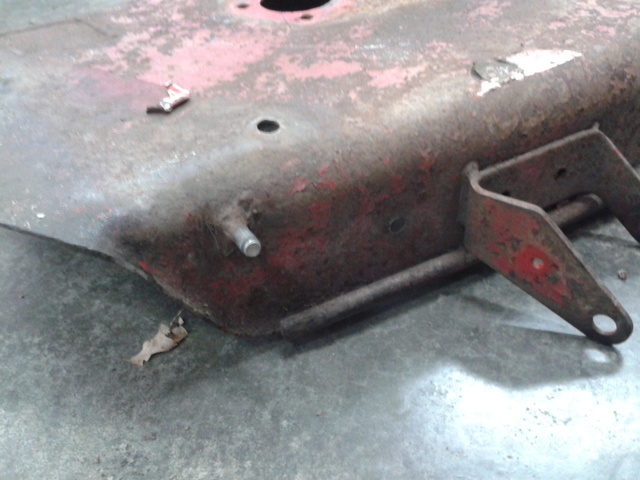

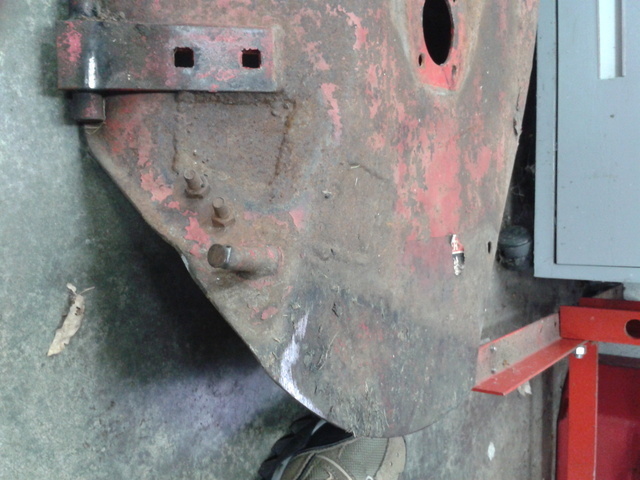

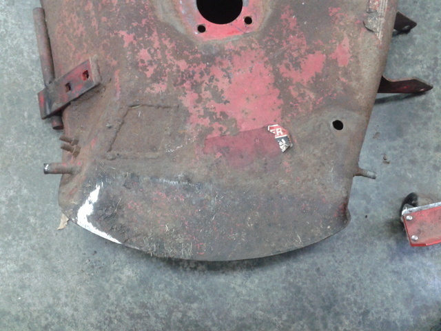

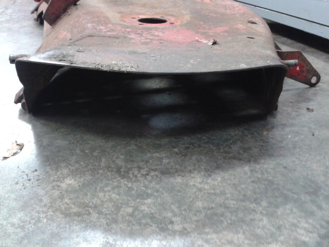

cleat 9,324 #1 Posted January 9, 2016 (edited) If you want to add a bagger or late model chute deflector to your older 48" deck this may help. Sorry for the condition of the deck in the pictures, it will look much better by spring. Wheel Horse 48 deck late model guard and bagger attachment points top view.pdf Wheel Horse 48 deck late model guard and bagger attachment points end view.pdf Cleat Edited January 9, 2016 by cleat Added PDF files Share this post Link to post Share on other sites
