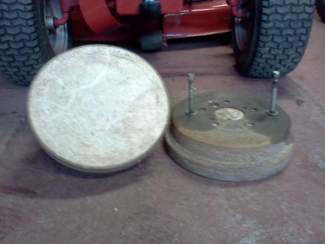

N3PUY 1,031 #20 Posted January 8, 2016 I got this WH this summer with weights on the rear wheels. PO poured them full of cement. Did a really nice job too. Even left plenty of room for the nuts. They weigh about 55 pounds each and that's with narrow rims. 4 Share this post Link to post Share on other sites
953 nut 70,330 #21 Posted January 9, 2016 52 minutes ago, N3PUY said: poured them full of cement I sure would hate to be the person who had to put those rims on the tire machine to change tires. Must say it looks like a economical way to ad weight. 1 Share this post Link to post Share on other sites
Tankman 3,528 #22 Posted January 9, 2016 (edited) Years ago we used auto brake drums, a couple of bolts, cement, Drill a couple of holes that match your rims. The brake drums from local salvage yard, drums sized to fit your rims. Once 'n awhile find myself thinking, "Stacked brake rotors?" Edited January 9, 2016 by Tankman 7 Share this post Link to post Share on other sites

kasey54 305 #25 Posted February 25, 2016 I recently bought a 875 wh that had home made lead wheel weights. Each rear wheel had two molded disks .the smaller inner one weighs about 60 lbs. The outer larger one is about a hundred pounds. The outer heavier one seems to be molded from an old hub cap. The inner one seemed to fit perfect, the outer one had a diameter about 1/4 inch smaller than the wheel horse wheel. There where roofing nails driven into the outer rim of the weight , I assume to center the weight to help align it to get the bolts thru.. The original owner used 1/4 inch carriage bolts that where an extremely tight fit. Ill bet he used some colorful language getting them to line up! I just went to my photos, I had them reversed . Share this post Link to post Share on other sites
