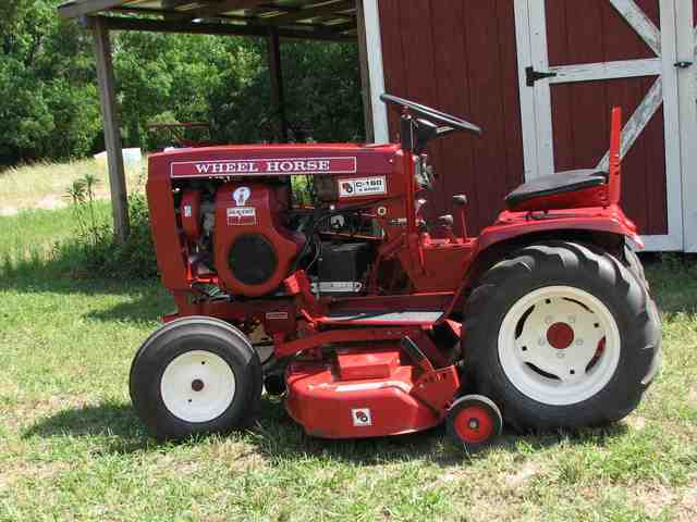

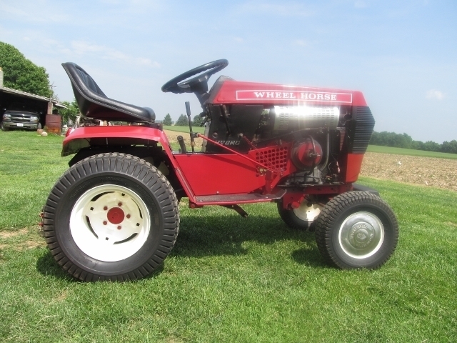

Ed Kennell 47,754 #2 Posted January 8, 2016 Here Ya go 9 Share this post Link to post Share on other sites
scotty 252 #3 Posted January 8, 2016 Just what i was looking for thank you! Share this post Link to post Share on other sites

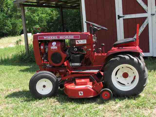

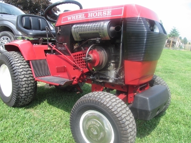

Racinbob 13,250 #4 Posted January 8, 2016 Here's a Commando 800 with Regal red I did for my grandson some years ago. With the conditions just right a rattle can paint job can look outstanding. Considering the conditions this tractor has dealt with since the restoration it has held up well too. 4 Share this post Link to post Share on other sites

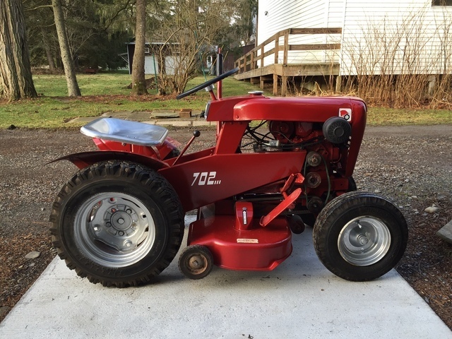

Regal_Red 103 #12 Posted January 8, 2016 Mine was done in Regal Red just this fall/winter. The paint was done inside our factory so the temp and humidity was consistent. Plan on painting the tires for the spring. With the help of all of the guys on the forum we've decided that it is a 701 with a 702 hood. I'll be removing the 702 from the guard. 5 Share this post Link to post Share on other sites

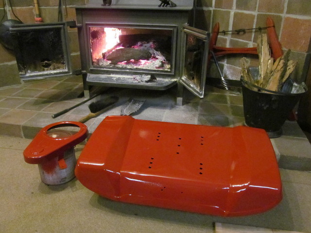

elcamino/wheelhorse 9,363 #14 Posted January 8, 2016 Scotty I went ole school , Couple of coats of primer ,sanding , wiping down with acetone. About 5 coats of GM 81 , 4 coats of of clear coat. This was on the seat pan. Check out my thread on separate lift for rear hitch on 310-8. Jim Winder 3 Share this post Link to post Share on other sites

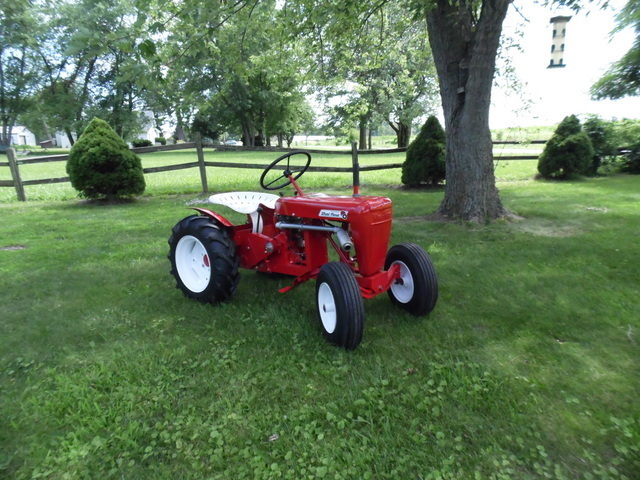

tbarnhart 240 #18 Posted January 9, 2016 Here's the August calendar picture from last year. Rustoleum regal red and canvas white. It does take a while to cure, but it seems pretty durable so far. It's been almost two years since its been painted and has worked hard since, but it still shines up pretty good. A few spots could use a touch up, but its really a worker and deserves a few battle scars. 6 Share this post Link to post Share on other sites

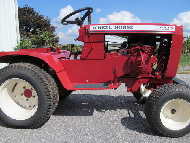

Wishin4a416 2,610 #19 Posted January 9, 2016 (edited) Edited January 9, 2016 by Wishin4a416 All small pieces were done with rattle cans. Sheet metal was done with a gun. 6 Share this post Link to post Share on other sites

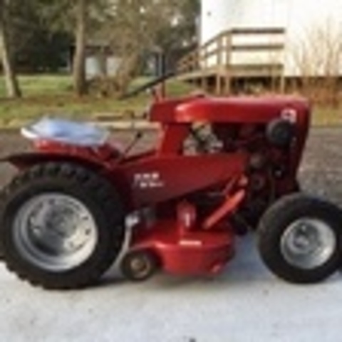

Molon_Labe 731 #20 Posted January 10, 2016 (edited) On 1/8/2016 at 2:11 PM, scotty said: Any other brands of paint that would be a little faster drying? I know krylon dries pretty fast is cherry red the only close color with krylon or is that the closest? I like the idea of paint and primer in one. Scotty, this one is painted with Krylon Rust Protector Gloss Classic Red and it does dry fairly fast for an enamel paint. Edited January 10, 2016 by Molon_Labe 1 Share this post Link to post Share on other sites
