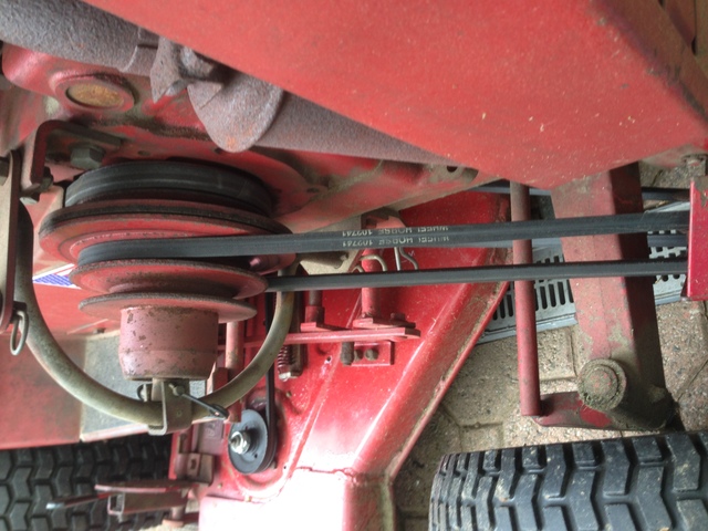

Moparfanforever 940 #102 Posted May 17, 2016 I noticed on you deck that on the center spindle you have your belt running on the smaller pulley and in post #60 that person has it running on the big pulley ?? Maybe that is a problem ?? 1 Share this post Link to post Share on other sites

clip 185 #109 Posted May 17, 2016 Are you running the mule drive off the inner/larger or outer/smaller groove? Share this post Link to post Share on other sites
formariz 12,381 #110 Posted May 17, 2016 5 minutes ago, clip said: Are you running the mule drive off the inner/larger or outer/smaller groove? Running it out of inner larger one. Belt will not be aligned properly out of the other one. 1 Share this post Link to post Share on other sites

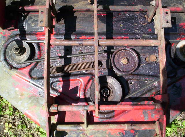

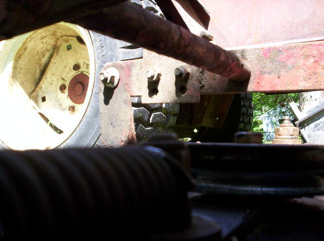

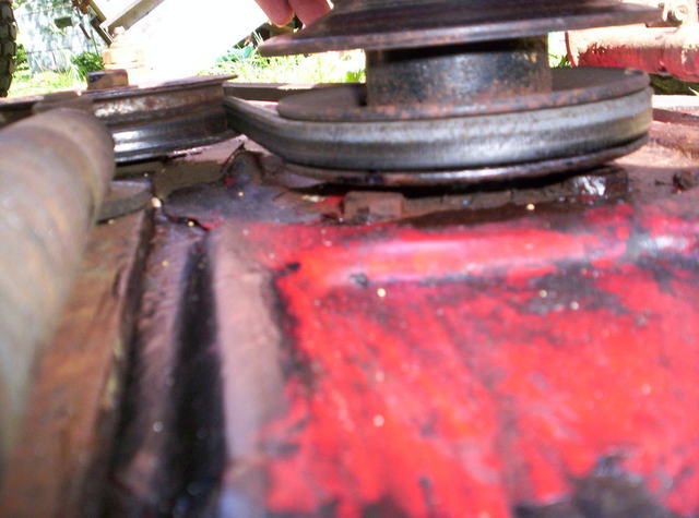

elcamino/wheelhorse 9,363 #114 Posted May 19, 2016 Formariz , It finally stopped raining today, I am going to pull my deck tomorrow after cutting grass to see if I see any difference between my deck and yours. Maybe something will jump out as being different. 1 Share this post Link to post Share on other sites

elcamino/wheelhorse 9,363 #116 Posted May 20, 2016 Formariz , I took pictures of my deck today , I hope that I can get the attached . Me and puter don't together sometimes. I haven't the time to compare my pictures to yours. 1 Share this post Link to post Share on other sites

TDF5G 2,074 #118 Posted May 20, 2016 14 minutes ago, elcamino/wheelhorse said: Formariz , I took pictures of my deck today , I hope that I can get the attached . Me and puter don't together sometimes. I haven't the time to compare my pictures to yours. Which hole is your idler pulley in? I was hoping to get my deck back together and compare it also, but I have not had time to even look at it. P.S. In case your wondering, I do my posting when I'm at work in between customers and phone calls. Don't have time for RS when I'm at home. Share this post Link to post Share on other sites

formariz 12,381 #120 Posted May 21, 2016 Jim I don't know if it is the angle of the photo but your idler looks much bigger than mine (story of my life). Mine has a 3"diameter. I see that your also belt rides on the bottom of the idler like mine.I actually reversed idler and it goes back to bottom. Do you have a digital tach so you could tell me what RPM your pulleys rotate at? Is your center blade larger than the others? 4 hours ago, Robert of Lake Michigan said: As a retired field service mechanic in a different field than this, at the start of my career I would receive an emergency call with a brief description of the issue then tried in my mind to anticipate the problem as I drove to the site. Time passes and I decide I can't see the problem when I can't see it. With the age of this Wheel Horse machinery in some cases, maybe yours, it is time to have some other eyes investigate your situation. I'm not encouraging you stop trying but you decide and I hope to your delight a revelation is revealed to you and then the repair can be made. Maybe a visiting friend with simply another view can see it, that has happened to all of us I think. Also having hands to wiggly and test parts is a thing we can't do. A person needs to do a field check of your blade spindles. That would be actually great but unfortunately I am the only wheel horse guy around here. I may actually be the only guy around here that cuts his own lawn! Believe me, spindles are fine. Totally rebuilt with new bearings run true and smooth. Same problem as before. I am tempted to take the tractor and deck to the show, and offer a prize for the person who solves this one in a couple of days. Plenty of grass to try it on there. 3 hours ago, grasscutter said: This serial is running too slow for me, wish I was in NJ re posts 102 and 108, the three spindle pulleys are definitely all the same diameter? - just wondered if the blade speeds weren't matched. Can the driving pulley stack actually be fitted the other way up ? But ofcourse if it was working fine before (you suppose?).....what did you do to it between then and when it started chewing belts. I don't believe in coincidence The two outside spindles pulleys are the same. Center pulley is larger so is blade in it. Driving pulley has to work this way on this setup. 1 Share this post Link to post Share on other sites
elcamino/wheelhorse 9,363 #121 Posted May 21, 2016 I think it is the angle of the picture 3 inch idler , center blade is larger. I don't have a tach, wish I did. I have looked at your pictures , compared to mine and the look the same. I have checked belt number idler pulley number both packing slip and actual package ( I know I am nuts but have them in two places) and everything appears to match with yours. Did P O mention any problems ? Could there be a weak place in the deck ? Old Weld? Notice any cracks in a spindle housings.After I cleaned the deck and sharpened blades today I spun everything just to check for noises. I think you deck problem is getting to me. Are you coming to the Big Show? If so throw deck in vehicle and we will have have everyone there , take a wack at it. Maybe an answer will appear. 2 Share this post Link to post Share on other sites

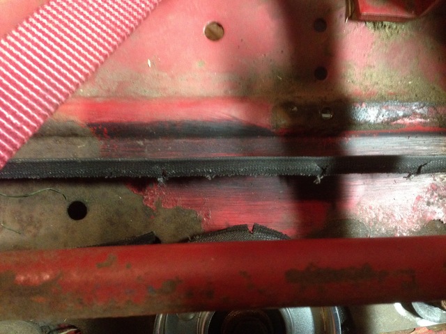

Ed Kennell 47,629 #124 Posted May 21, 2016 On 1/4/2016 at 8:15 PM, formariz said: I keep going back to these first pictures you posted. Those well defined missing sections of the belt certainly look like they were machined away, and IMO the only way that could happen is if the deck belt stopped moving when the center drive pulley was turning. But you would have to have smelled burning rubber and seen smoke if this happens. Could that center pulley have a wide spot that allows the belt to contact the bottom of the pulley momentarily ? 1 Share this post Link to post Share on other sites
